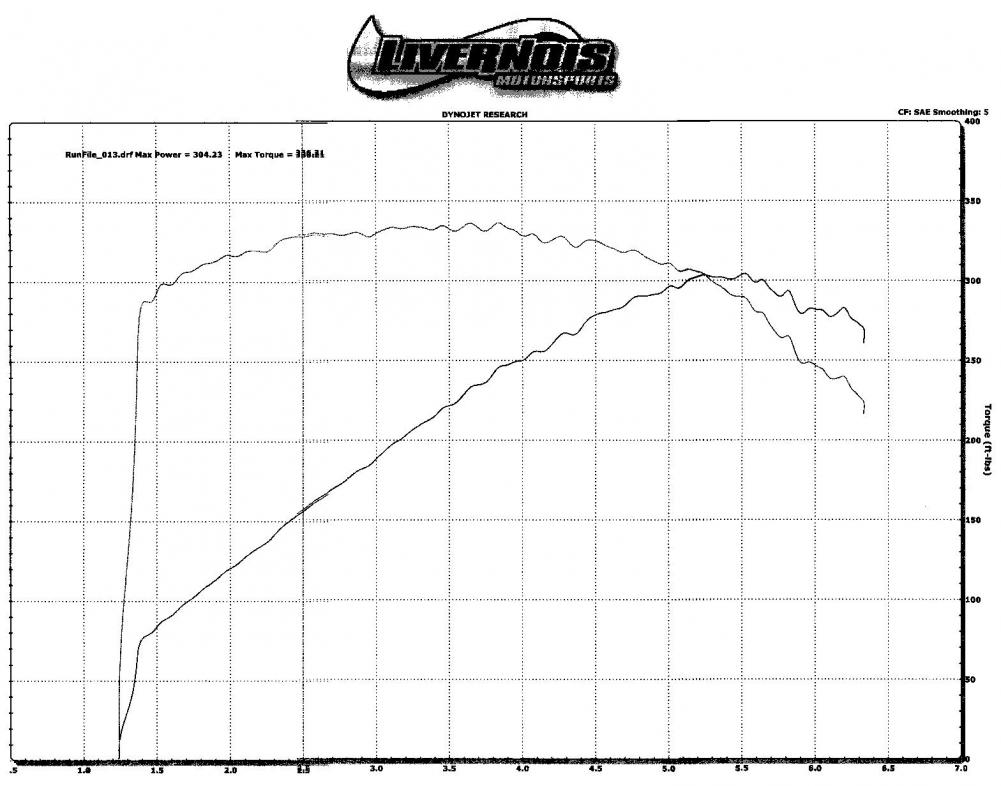

I have the final numbers after the tune on the chassis dyno.
304hp at the wheels (approx. 5250rpm) (Stock was 186hp)
336ft/lbs max torque (approx. 3800rpm)
Note: 290ft/lbs torque at about 1350rpm. The torque line goes straight up from idle to 290+ at about 1350rpm then gradually increases until max at about 3800rpm.

Forgot to attach the dyno sheet on original post.
Attached Thumbnails 08 Alpha Final Numbers with Supercharger-final-dyno-numbers.jpg
Using a proportional equation, your 300hp. stock engine is now producing 490hp.!

The 304hp is with 35" Nitto tires mounted on 18x9 Cepek wheels. The guys are saying with the stock tires/wheels we would even see a higher hp number because they are much lighter.
As far as the 490hp at the flywheel goes it's probably more like 420-425hp or so. Mounting the supercharger increased the hp, but would not proportionately increase the hp lost through the drivetrain.
So, at 300-305hp from the factory, the 186hp at the wheels means we lost about 114-119hp through the drivetrain. Add 114-119hp to 304hp and you get about 418-423hp.
Still pretty cool.

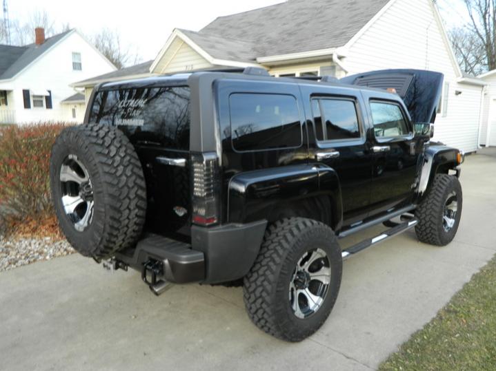

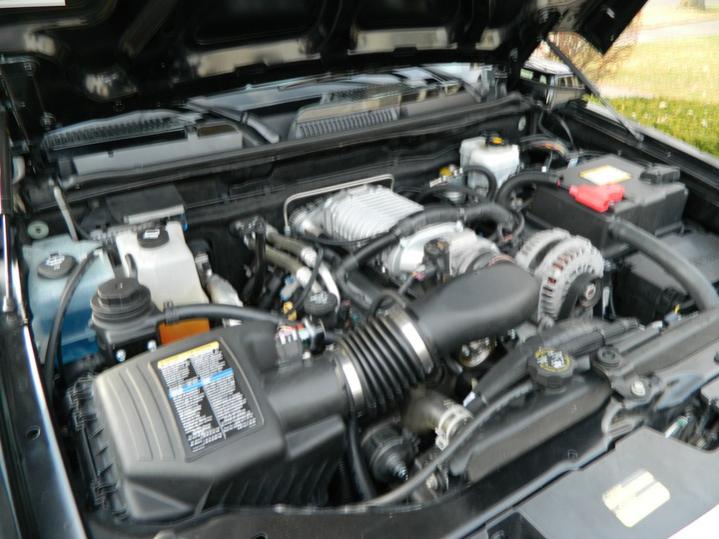

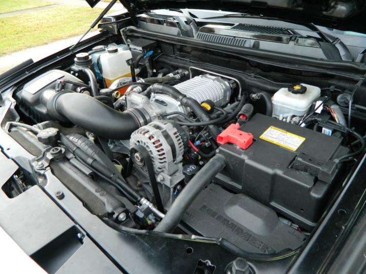

A few pics of the finished installation. Now just a few things to do to the exterior and it'll be time for the next project.
Attached Thumbnails 08 Alpha Final Numbers with Supercharger-blower-installed-resized.jpg   08 Alpha Final Numbers with Supercharger-supercharger-installed-resized.jpg   08 Alpha Final Numbers with Supercharger-blown-h3-resized.jpg   08 Alpha Final Numbers with Supercharger-kids-resized.jpg   08 Alpha Final Numbers with Supercharger-back-resized..jpg
