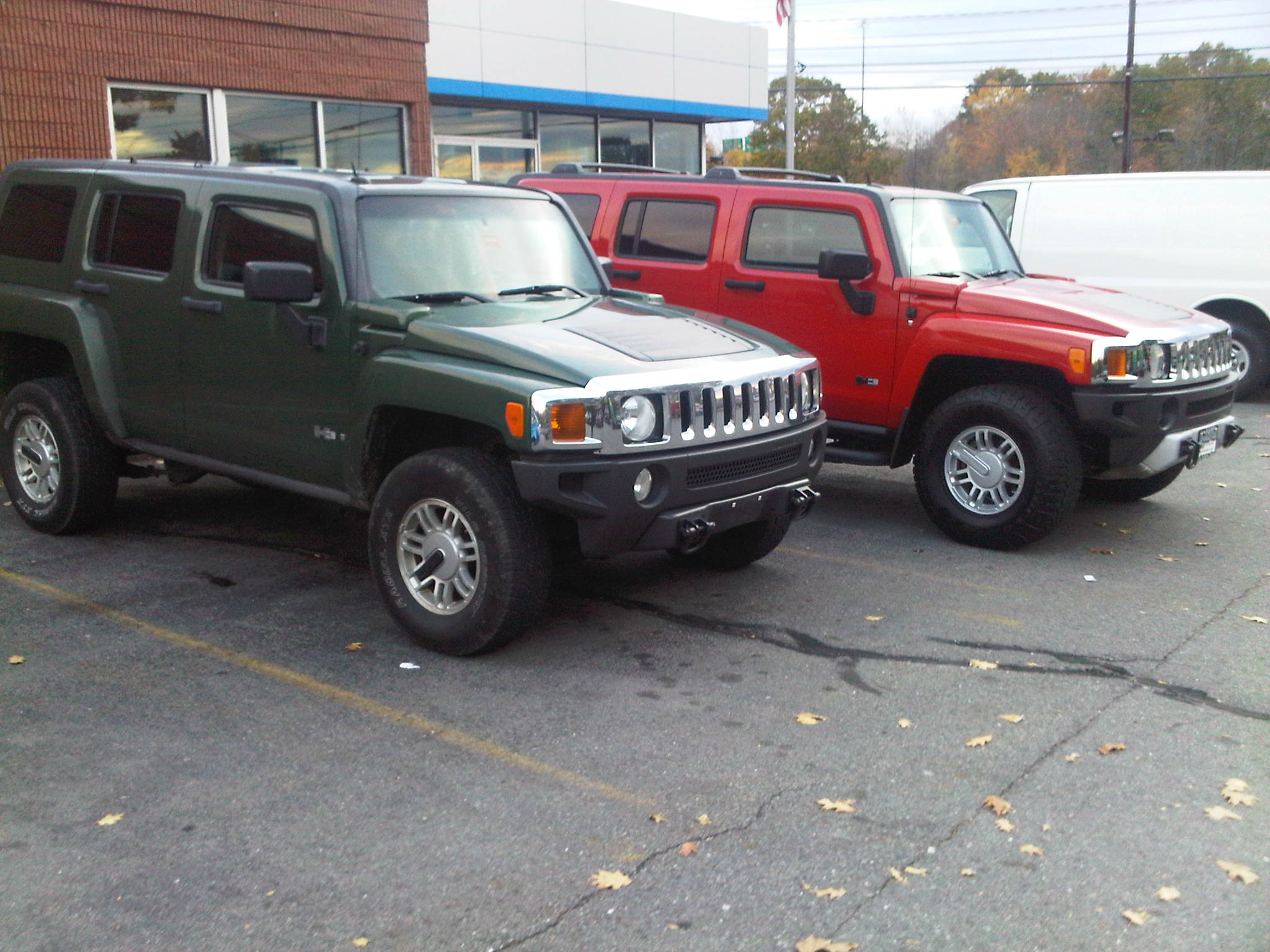

My '06 was a 5 speed and so is my '09 Adventure. I've always had a preference for a manual trans. The H3 radiators have been known to blow coolant into the auto trans cooler and cause catastrophic tranny failures. 3.5L to 3.7L was a noticeable improvement on the highway especially up hills, but not earth shattering.
