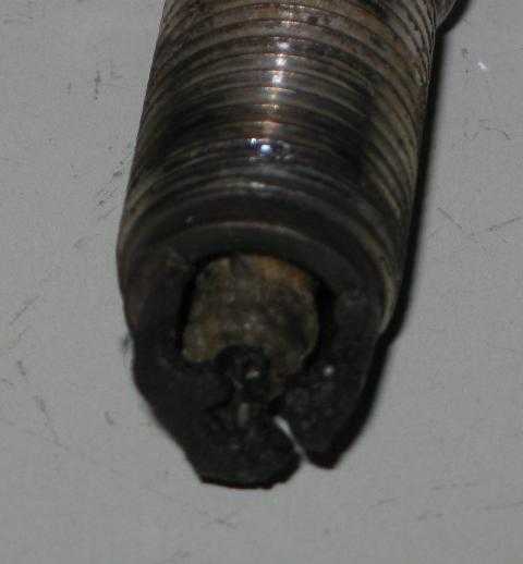

Get those aftermarket plugs out of there NOW. ASAP. Don't even think twice just do it. Your OEM ones are good for 100k miles.
The proper plug for your vehicle is AC-Delco part # 41-103
Unless you want to end up with possible serious issues, and a plug that looks like this, you need to go back to your OEM plugs. These trucks use an HEI ignition and aftermarket plugs just don't hold up like the OEM ones do.
edit: The picture is from another forum where a user there experienced your same issue with the engine light after changing plugs. It then left him stranded and ruined his vacation. The below plug cost him $300 said and done after the trouble it caused.
