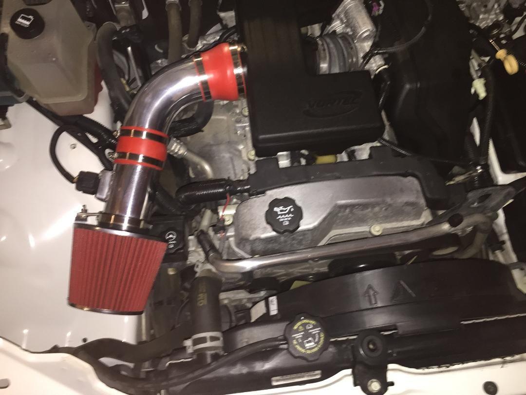

Old Feb 26, 2018 | 10:02 AM
You bought the wrong intake for your truck.
An aftermarket air intake will cause a CEL when there is a leak downstream from the MAF, and on the 2008+ they were designed with the EVAP system tapped into the Air Filter box. When you remove the Air Filter Box and open up the EVAP connection, that can also lead to your issue.
If you were to use a closed performance intake system, instead of an open K&N type system, no CELs.

OK Doc Olds, here is a photo of the installation. You will notice that the hose from the evap can is not routed to anything. I suspect that is what is triggering the CEL. The other hose from the manifold that connects to the underside of the stock box (marked Vortex) is properly connected. I am wondering if I run a new hose from the evap can to a fitting I would install in the black Vortex box, if that would suck whatever from the evap can and not cause the check engine light to come on (and the P0171 code). What do you think about that as a work-around?
