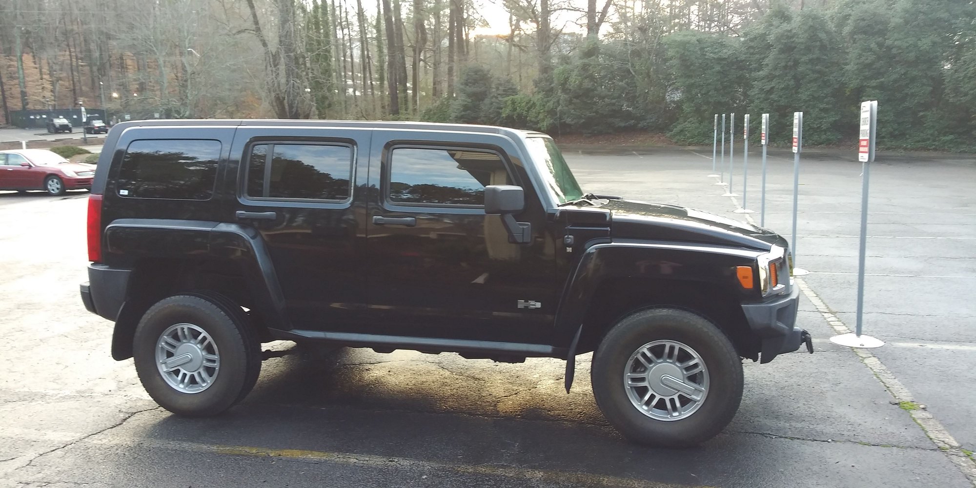

I purchased my used H3 with approx. 151k miles from a dealer about 5 days ago. I have two errors. ABS fault, STAB SYS failed service...and low tire SERV TPM. I am taking it to the dealership tomorrow as I know nothing about vehicles and I want to get it overlooked so I can plan my maintenance. I believe I saw two outstanding recalls which do need to be addressed with it. I am really excited that I was able to get my Hummer as it was the first thing on my Bucket List for myself. Now, I want to maintain it and drive it as long as possible.

Looks like a nice rig. Those are codes that can come and go. Not serious in my opinion.
