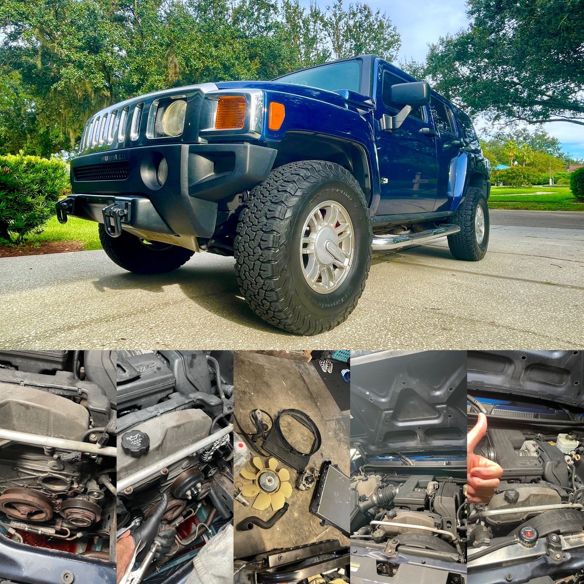

Just picked up a pretty much bone stock unmolested 2007 H3 with only 79K on it. Looks like the rad has been replaced and has a touch screen where the radio should be.
Very happy so far, well see what the future holds. Has 285/75/16's on the stock wheels. Just going through it, replaced all the door handles, bump stops, about to upgrade the shocks.
Has a very slight seep from the front diff but otherwise tight. Any suggestions on things I should look out for or any preventative measures I should take? Thanks!

Thank you for that detailed reply!
I crawled around it a bit and it looks like it has a new transfer case actuator and luckily, it doesn’t have a sunroof, which I prefer anyway.
There is a newer radiator in it but I plan on upgrading to a bigger aluminum one with electric fans, hopefully that will keep the temp under control, it’s always HOT in Florida! The forward eyes on the leaf springs are in good shape but the drivers side rear is a bit crusty, possibly from some boat ramp action, will eventually have to do some welding there.
Thank you again, I’ll post the updates.

Water Pump, 3 core radiator, alternator, belt tensioner, idler pulley, tune up & coil packs, belt & hoses, fan clutch, running way cooler and idling smooth. Next is shocks and a fuel sending unit and probably an E-brake cable, plus a drivers side headlight assembly because I got the condensation. Very happy I bought this thing!...so far
