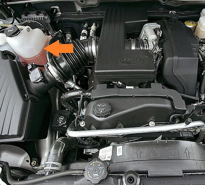

Posts: 9,014
Check/repair that leak.
Old Jul 4, 2020 | 07:54 PM
Lord_Vien's Avatar
Joined: Jul 2020
Posts: 115
yeah i took the pic after i opened the rad cap to check some spilled out.
Old Jul 4, 2020 | 08:44 PM
Posts: 9,014
Not a good idea removing rad cap when hot. Btw, you can monitor your coolant level here:
