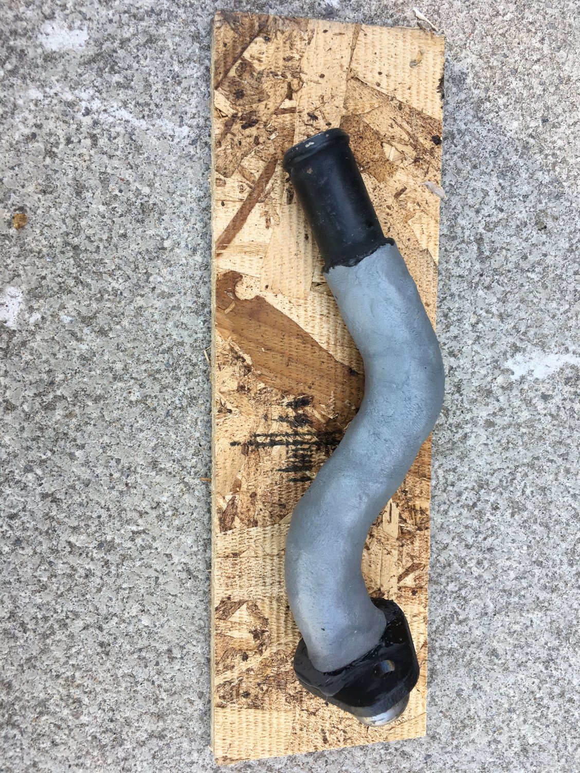

Had my rig a few weeks now and blew a Hole in the hvac coolant Inlet pipe, I have a 2006 model and this part 12564053 is discontinued, and I can’t get it new anywhere across all of America and prob the world so I fixed mine. Wire wheeled it, sprayed it with rust paint did 3 light layers of jb weld strong bond, then finished it off with 3 mil layer of 400 degree 600 psi jb weld for high heat and coating of high heat paint, should be the strongest part of it kind in the world haha, just have too let cure and install and fill coolant will keep everyone posted

I wouldn't trust a fixaflat miracle seal stop leak, on a coolant system part. 12564053

I didnt have much of a choice, if you know a better solution that would help

shes all back together filled with coolant, test ran it around the block then let it sit for 30 min, checked the fluid lvl, all was good, took it for a longer drive and let the vehicle get to temp, seemes to be working fine. I will change the thermostat and get the coolant changed next week before I drive it too much.
