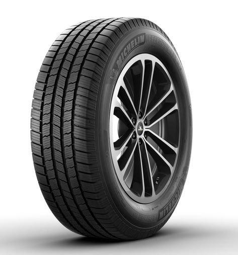

hi. i have the 4 new michelin defender 20 inch tires on the hummer accessory 20 inch wheel. maybe 700 miles on wheels and tires, 97k on truck itself,

Post side view pictures of your tires/wheels showing the balance weights.
Btw, Michelin defender tires are NOT meant for alltime4wd off road!
