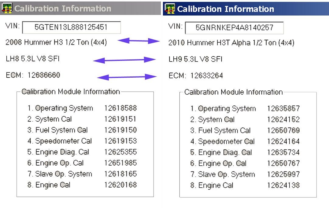

The builder ( not the shop that is now trying to fix all the problems) got a chassis directly from GM
They then bought a 6.2L that was in a 2008 H3 and the wire loom
In the end the H3T Alpha ran very poorly as the builder used a tuner in another state using HPtuners and when that did not work the builder then went to another tuner in another state.
In the end builder ended up with 2 PCMs that were of a different model but both are E67s.
I do not know what the difference are and
Each had a GM PCM calibration
1 was for a 2010 H3 with a 5.3L engine and the other
PCM was GM calibration for a 2010 H3T Alpha also for a 5.3L engine
Even though the engine is from a 2008 H3 with a 6.2L engine so both tuners did not tune for this engine

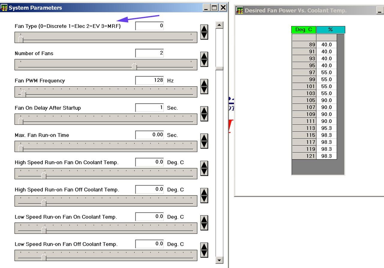

Then there was electric coolant fans issue
builder added those and some relays, I do not know how they are wired but do know when the shop turned a/c on the fans come on but shortly shut down
I had the shop send me a OBD-II scanner recording and had them include the A/C PIDs.
In analyzing that data I found the builder did not freon charge the A/C and had low pressure which would cause fans to be shut down
Remaning question you all might answer is what is needed IF the builder wired the fan relays to the correct pins of the PCM what then in tune is needed to make the PCM control the fans ?
What type fan logic is needed as shown below ?
Many thanks
PCM fan control
Compare of both PCMs

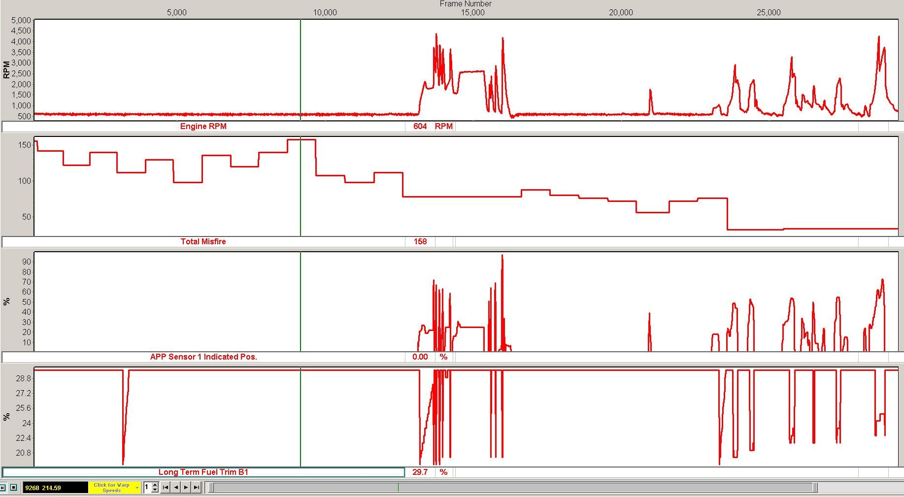

For those with the interest of this Hummer H3 Alpha
I had the shop the owner sent vehicle to use a good OBD-II scanner in record mode and then email to me to analyze
It was clear by the data that they used another PCM and did not bother to relearn the crank position sensor
nor the TPS (APP, drive by wire) and because of that there was a high amount of misfire even at idle and the TPS values all over the place
Once the shop did those relearns the engine got better
To make it worse whoever the tuner was had not done this so instead they were trying to tune the PCM calibration around the problem
and made the total PCM tune much worse
The PCM used and the GM calibration was for a 5.3L engine with flexfuel yet a 6.2L engine replaced that engine
Clearly the tuner did not know what he sells as his business and because of that this Hummer has sat parked for over 1 year

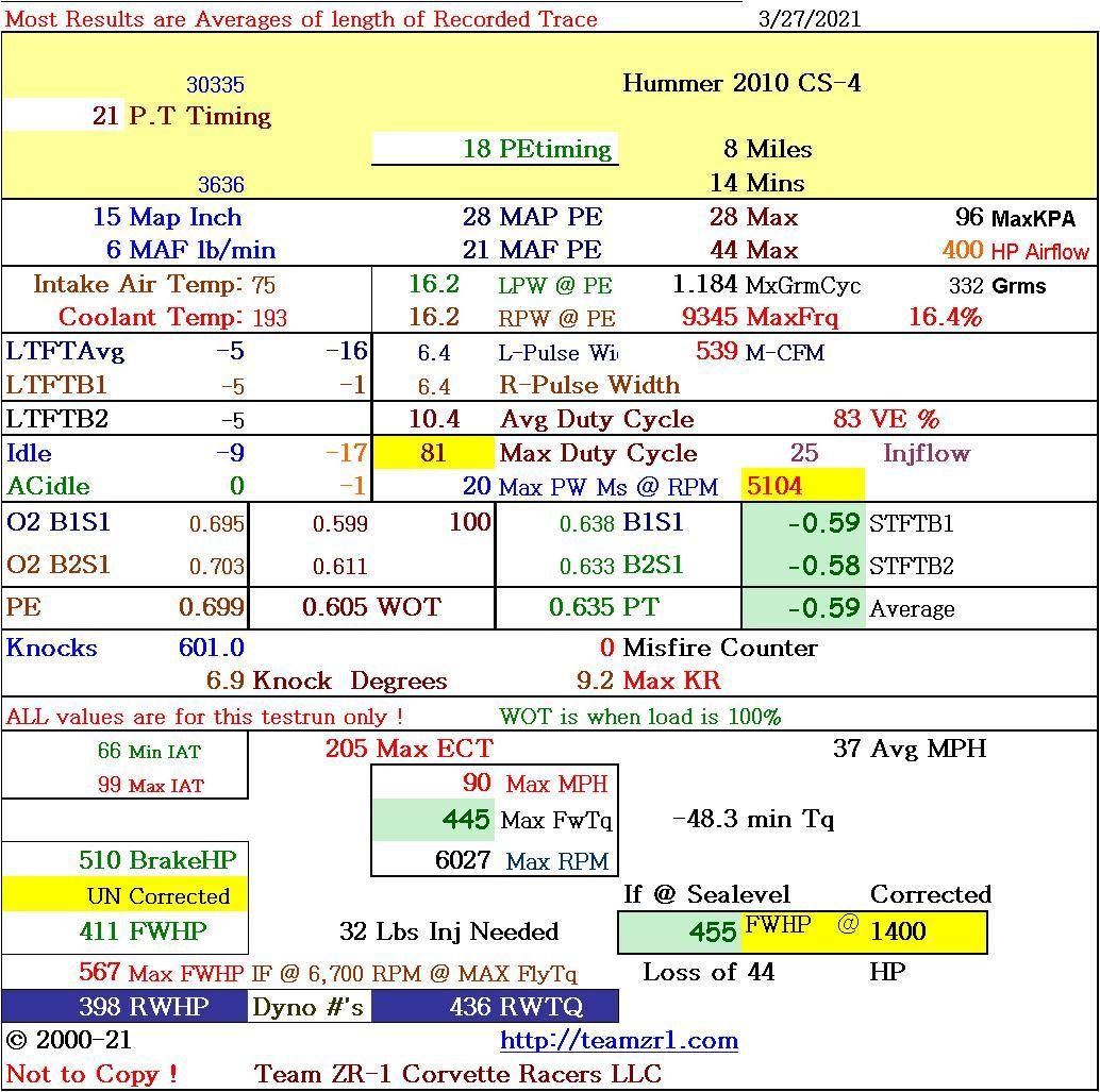

Working with the new shop and doing what I suggested they do I obtained a GM calibration and flashed that into the PCM and via the
testruns shop did with the scanner recording and sending those to me to analyze I custom tuned the PCM and the TCM for the A4 tranny
Where the other tune that vehicle would only put out about 260 flywheel HP and about the same for torque
Now with the tune I did the fuel trims are good, all misfire gone and flywheel numbers are in the 450ish for HP and Tq
Lots of misfire at idle and TPS not rezoned to PCM
How the engine functions after I tuned the calibration for the makeup of this 6.2L engine reported by a road testrun Will get better after few more drive cycles
