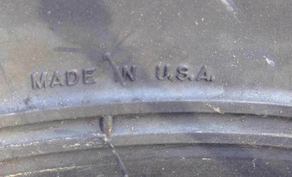

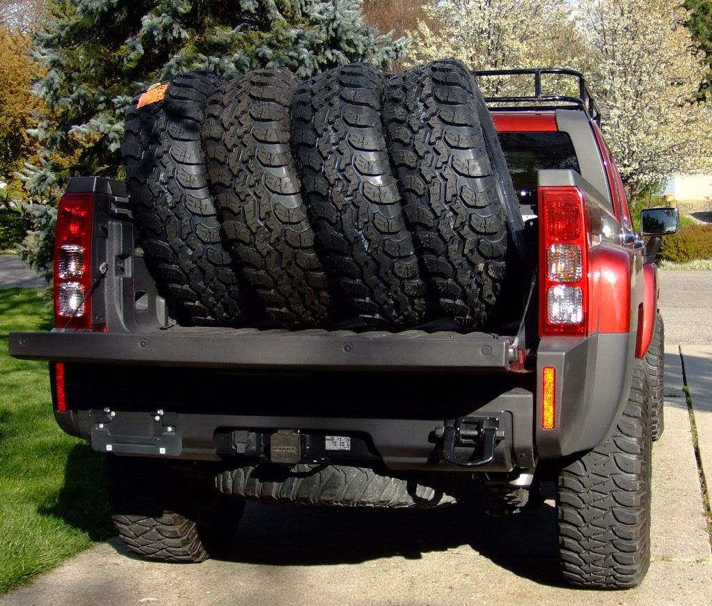

Day 13: Some new shoes (IroK NDs IND-24) arrived for Mr. Red Roc'T! Maybe I'll have his new shoes mounted and balanced tomorrow?
Made in the Good Old USA!!!! :usfl:

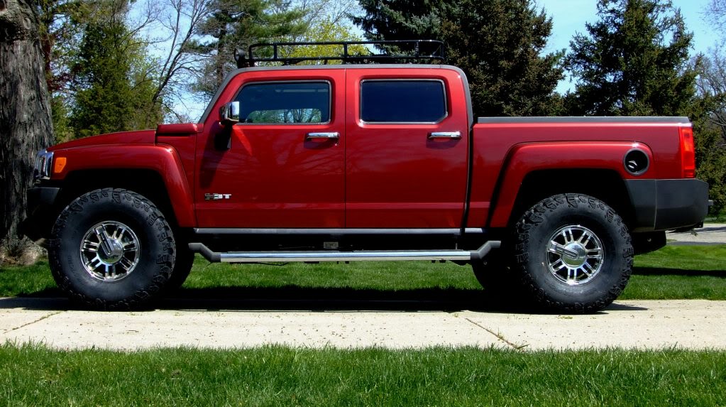

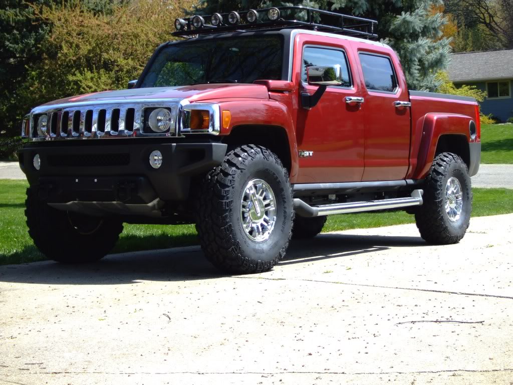

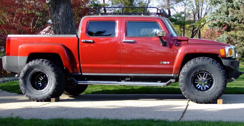

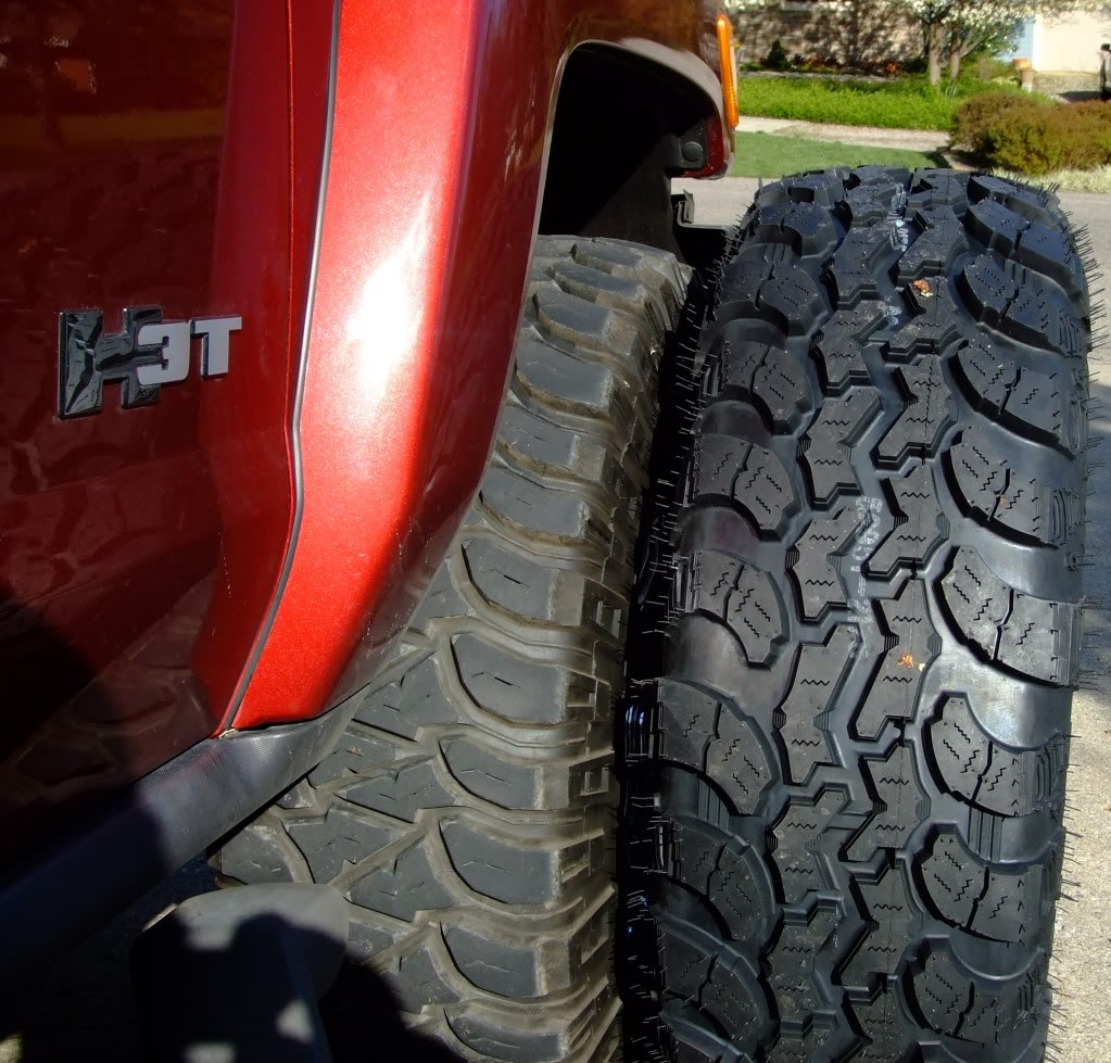

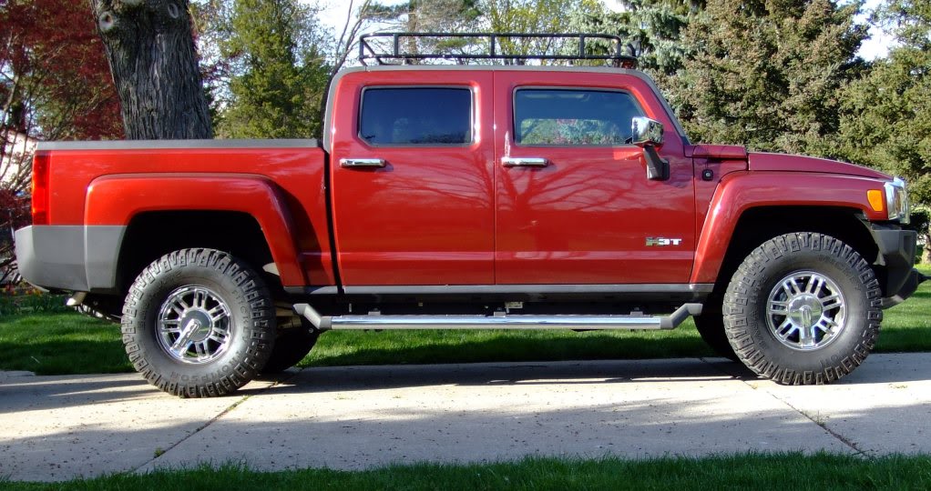

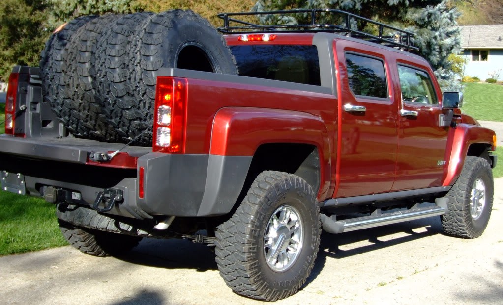

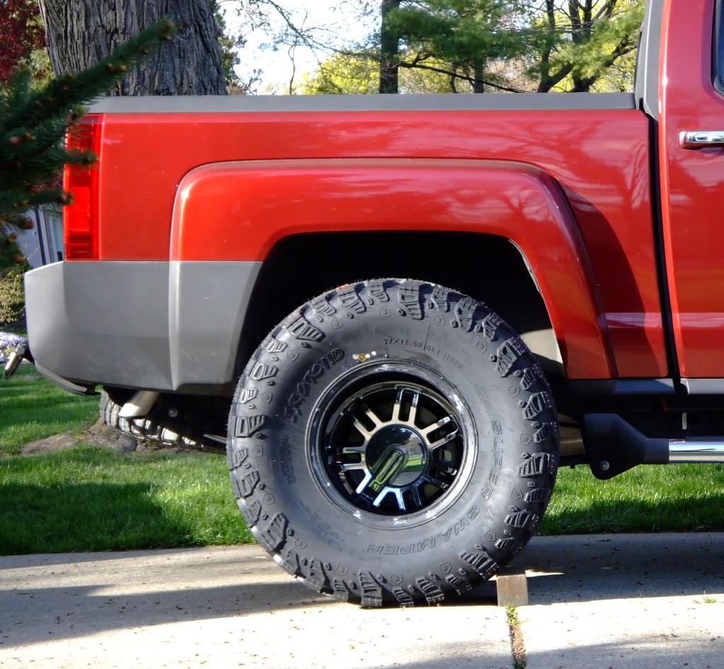

Day 14: Mr. Red Roc'T had his new shoes installed.
Before:
After:

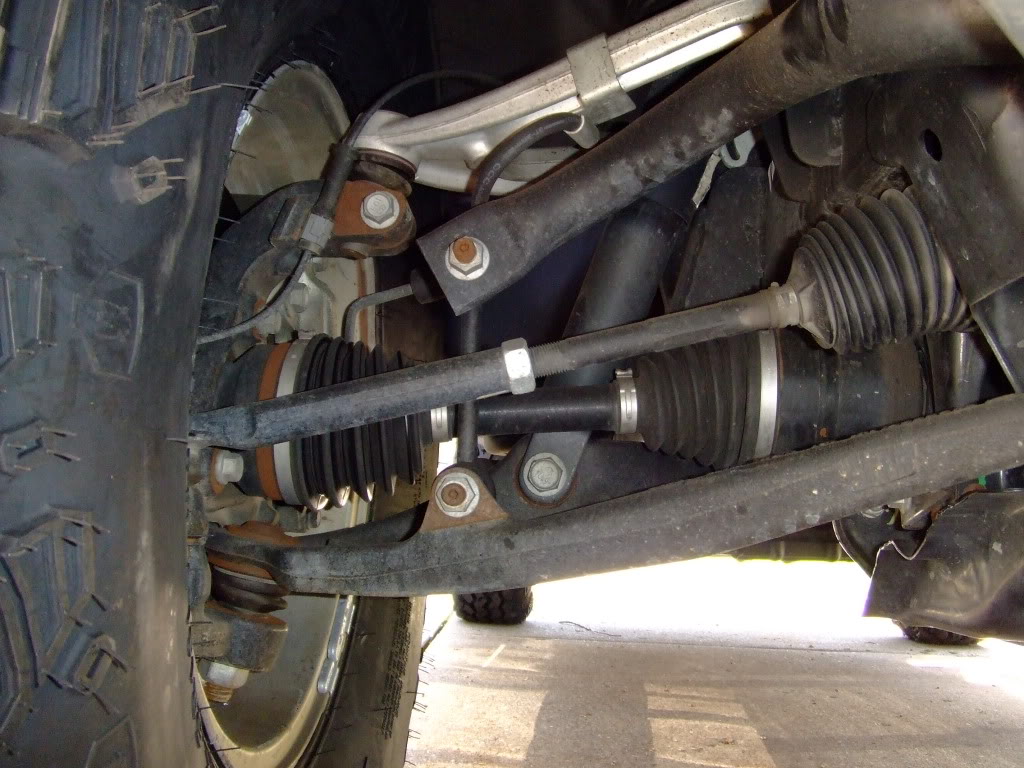

Mr. "T" is @ 24" now without the bumper, winch and Rock Rails, Mr. Red Roc'T next to him. "T" is @ 11 1/4 to the lowest point of the front diff skid plate. Red Roc'T is @ 12.5" with the half shafts almost paralell. I'm thinking maybe a 1/4" to a 1/2" more (@22 3/4" now)of T-bar cranking once the bumper, winch and Rock Rails are installed.

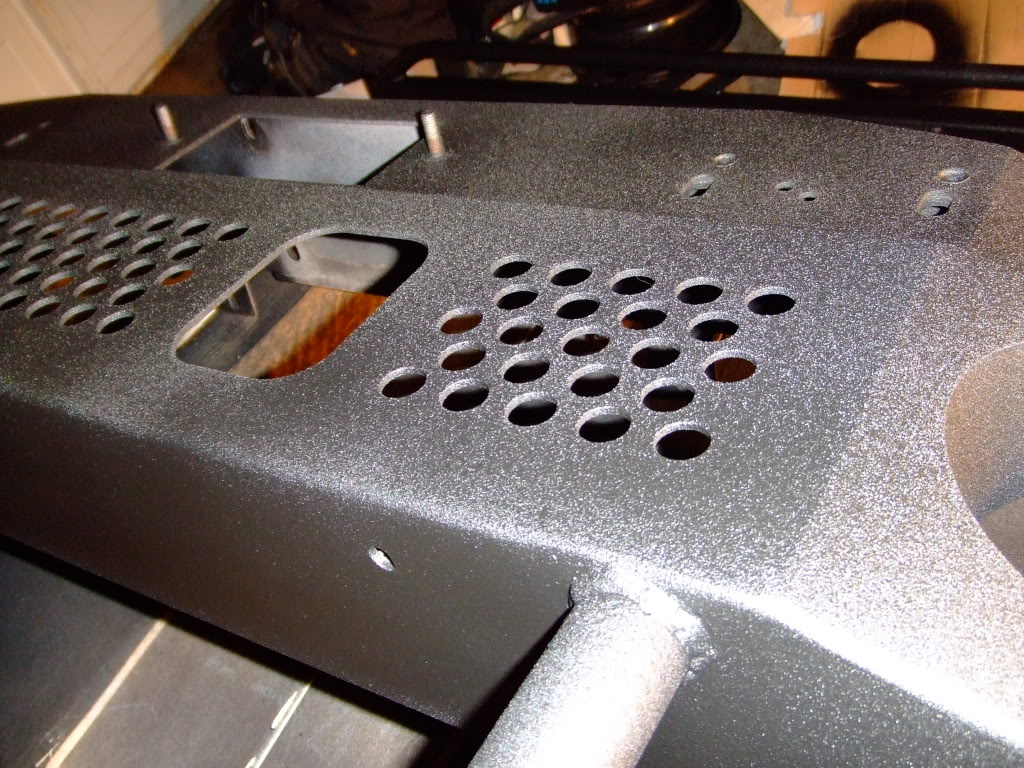

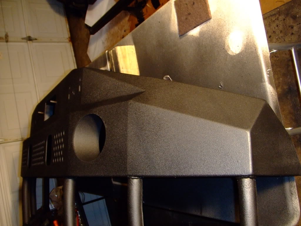

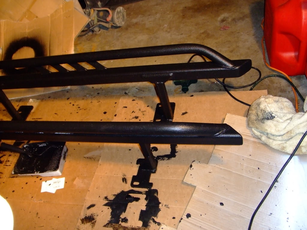

Day 15 (well night 15): Had 1 heck of a week @ work so I got home @ 8am and slept until 3pm. Needed that!
Picked up our BA bumper and RR Sliders tonight from the Media Blaster Guy. Picked up Duplicolor Bed Armor Kit and some spray cans. Rolling the Sliderz and spraying the BA. We will see how it holds up. I went with the Duplicolor kit and spray becaus I am a DIY guy and it is the only one I found that could be "touched up" with the original product without removing/sanding the existing coating. The product will bond to itself even after it is cured. A bonus for Rock Rails and Front Bumpers!
Prep: cleaned everything with brake cleaner and wiped down with lint free rags. According to all that I have read about the Duplicolor Bed Armor no etching primer is needed (plus the media blasting etched it for me).
I know you all want pix so there they are (YES, my garage is TRASHED, I have been trying to work on 3 HUMMERs, 2 R&R for sale and the build of Mr. Red Roc'T):
Media Blasted BA
Duplicolor Kit
BA First Coat
BA Second Coat
RR Sliders First Coat (will have to wait until tomorrow fo the 2nd):
Nurse bars may come off tomorrow if I wake up early and recoat the sliders and they dry in time!!!
