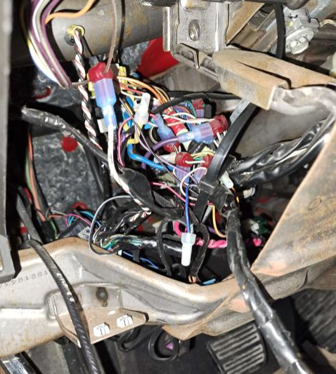

hi yall, just purchased a H3T and it has a absolute nightmare of a wiring setup for the aftermarket remote start along with a couple things unplugged and a purple wire cut.
Originally the passlock was flashing but we let it sit for 10 minutes and went to solid and then off, now it decides to go solid or off. if we crank the engine it clicks once and stops but still drawing power as all lights dim. We discovered if we wiggle one of the wires in the aftermarket remote start it will click constantly but won't start. I have a feeling the engine is seized but I'm not sure or its just bad wiring, I don't exactly recall but I think the crank was moving back and forward just a hair I'm not sure. I hope the engine isn't seized but if it is then I have other plans for this vehicle. I guess I'll take any advice and update this thread with any discoveries
rat nest of aftermarket wiring

Originally Posted by dillpickle02
If you cannot remove the wiring and repair/seal ALL of the cut/mangled wires yourself I would suggest finding a shop who can and will do it properly.
Those G'D' scotch locks are so bad for automotive wiring.
I can 99% guarantee that your starting issue is buried within that thing in your photo.
