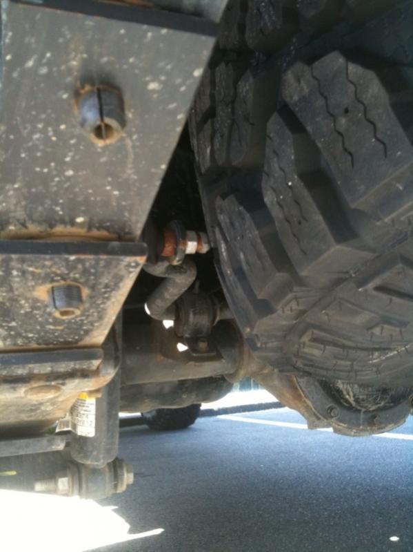

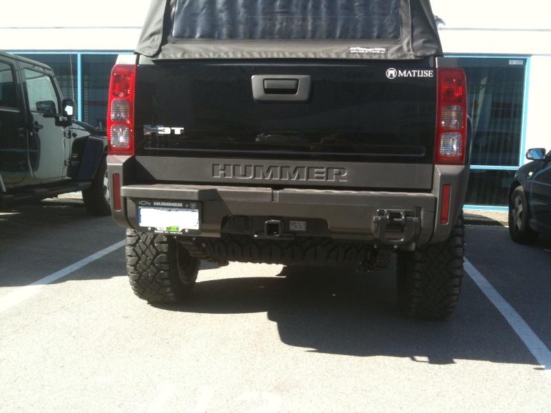

Got mine down with no problems at all.
Sugar, your 35 tire will fit but just barely. I put mine under but took it off right away as it hangs down very low and would cause problems off road.
I will try and find pics to show you

Here are a couple pics

If the secondary latch hasn't engauged it just drops down like nothing, but I think I knocked my tire loose off-road last time and it engauged. If that happens don't mess around with your jack-stand like the instructions tell you to, just tighten it all the way up, then overtighten it until it makes two popping noises and it disenguages... way easier.
Hmmm, those pictures are tight. My spare is a 30$ junkyard one so it is pretty bald, I might have a bit more clearance.
