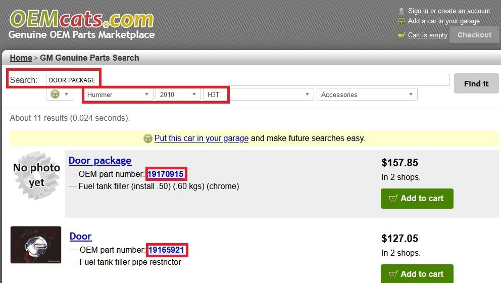

Originally Posted by TAINTER
HAHAHAHAHAHA, same stupid azz GHETTO website.
Try an actual GM PARTS website. I know you will never admit you are incorrect HUMMERZ.
I will type SLOW just for you.
The fuel door package consists of 3 parts: DOOR, BEZEL, & POCKET(aka housing).
2 designs, the doors are not interchangeable. If you want to install just the pocket then remove all and just install the 15794626, yet OP was looking for the bezel which is included with the 19170915 I posted above.

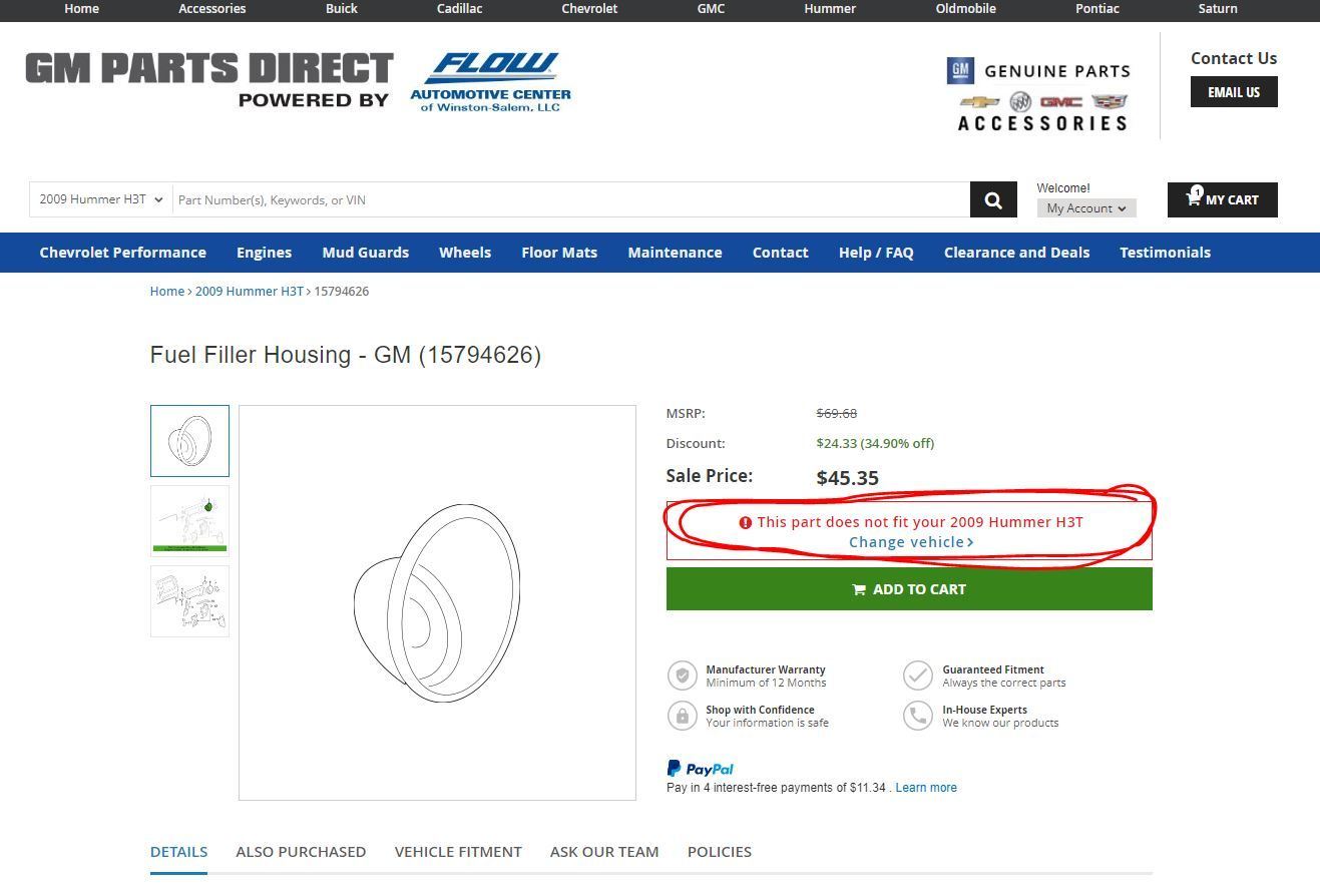

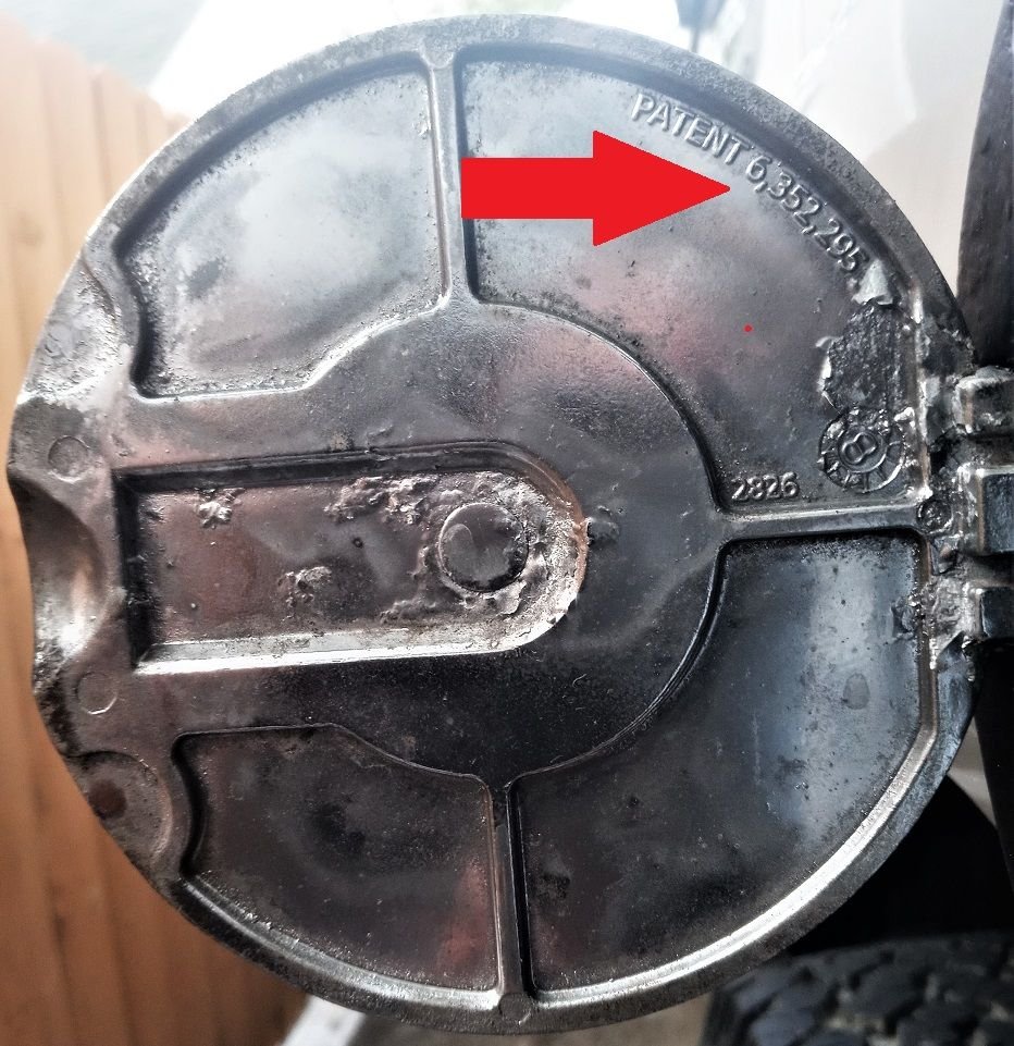

The H3 and H3T fuel door pocket are very different. Just because your Ghetto azz site says it fits does not mean it fits.
Come on HUMMERZ, H3T specific parts are not your forte and that's OK.
Give me H3T "specific" part numbers?
ALL PARTS ARE MARKED!
My OEM fuel door is marked with an '02 patent:>>>>US 6,352,295
and will fit any H3&T with my bezel.
That's a fuel DOOR not the pocket. Keep digging, I'm sure you will somehow convince yourself of something...

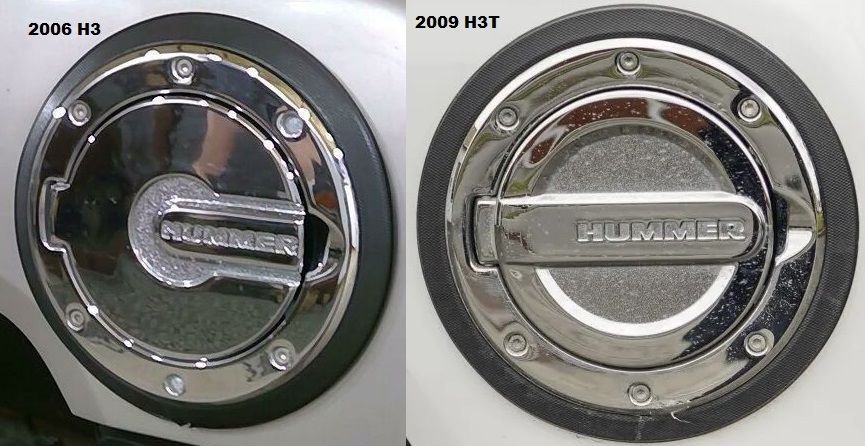

I'm still waiting for your H3T "specific" part number?
As I previously stated there are 2 designs.

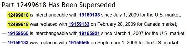

Picture shows difference between 1st & 2nd design: 2006 H3 and 24k-Mile 2009 Hummer H3T Alpha
1st design has 4 part numbers, used 2006-2009, 2nd design only has 1 part number used 2009-2010.

The pocket is the same on both 1st & 2nd design H3&T, the bezels/doors are off by 1/8" diameter.
Pockets can be found here::::>>
15794626

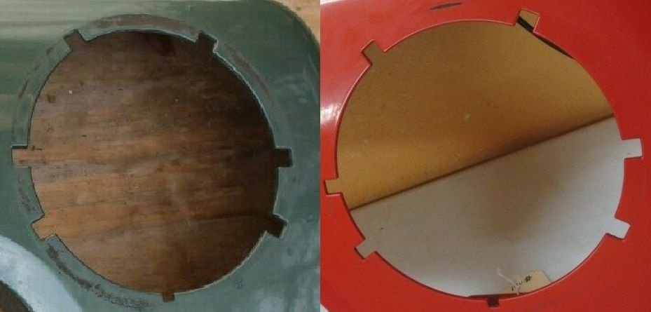

Originally Posted by Chubs
I should have proof in a few days. So exciting! The drama!
With the same cutout on the quarter flare as the 3, GM did not need unique parts for the T fuel tank filler.
