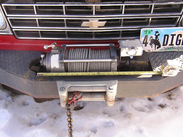

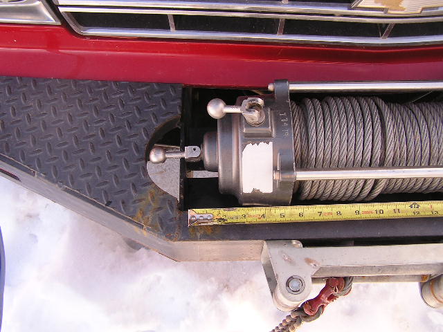

Here's some info and things to think about.
1'st pic is showing dimensions of MM 9000 hyd on an S10. The drivers side has 7" outside of the mounting holes which are just outside the drum.
2'nd pic is to show the one control lever clearance that is required, notice the cutout in the bumper to accomodate.

Attached Thumbnails The Great H3/H3T Hyrdualic Winch Thread-p1010030.jpg   The Great H3/H3T Hyrdualic Winch Thread-p1010031.jpg   The Great H3/H3T Hyrdualic Winch Thread-p1010032.jpg   The Great H3/H3T Hyrdualic Winch Thread-p7100011.jpg   The Great H3/H3T Hyrdualic Winch Thread-winch-mount-7-08-007.jpg
