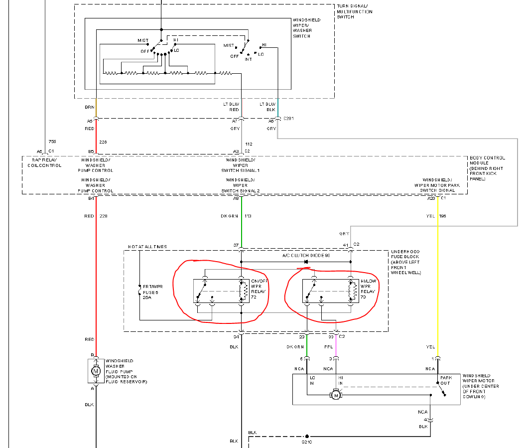

noticed something weird with my wipers the other day, every setting on the dial works, except the highest speed. I did some googling and saw people had problems with wipers only working on high speed. But no problems like this
When you put the wipers on the highest setting they freeze in place, and they only return if you turn the wipers off. In fact, once they freeze, even hitting the windshield spray button doesn't make them move. Only way to fix them is to turn them all the way off and they return to rest.

Swap relays #73 & #88 and recheck.

I second that. I had one fail, though I couldn't find it by swapping. I tested on the bench (intermittent problem - wipers would stop in the middle at times).
Parts stores did not have the relay - the GM dealer had on in stock, however, at a reasonable price as I recall.
