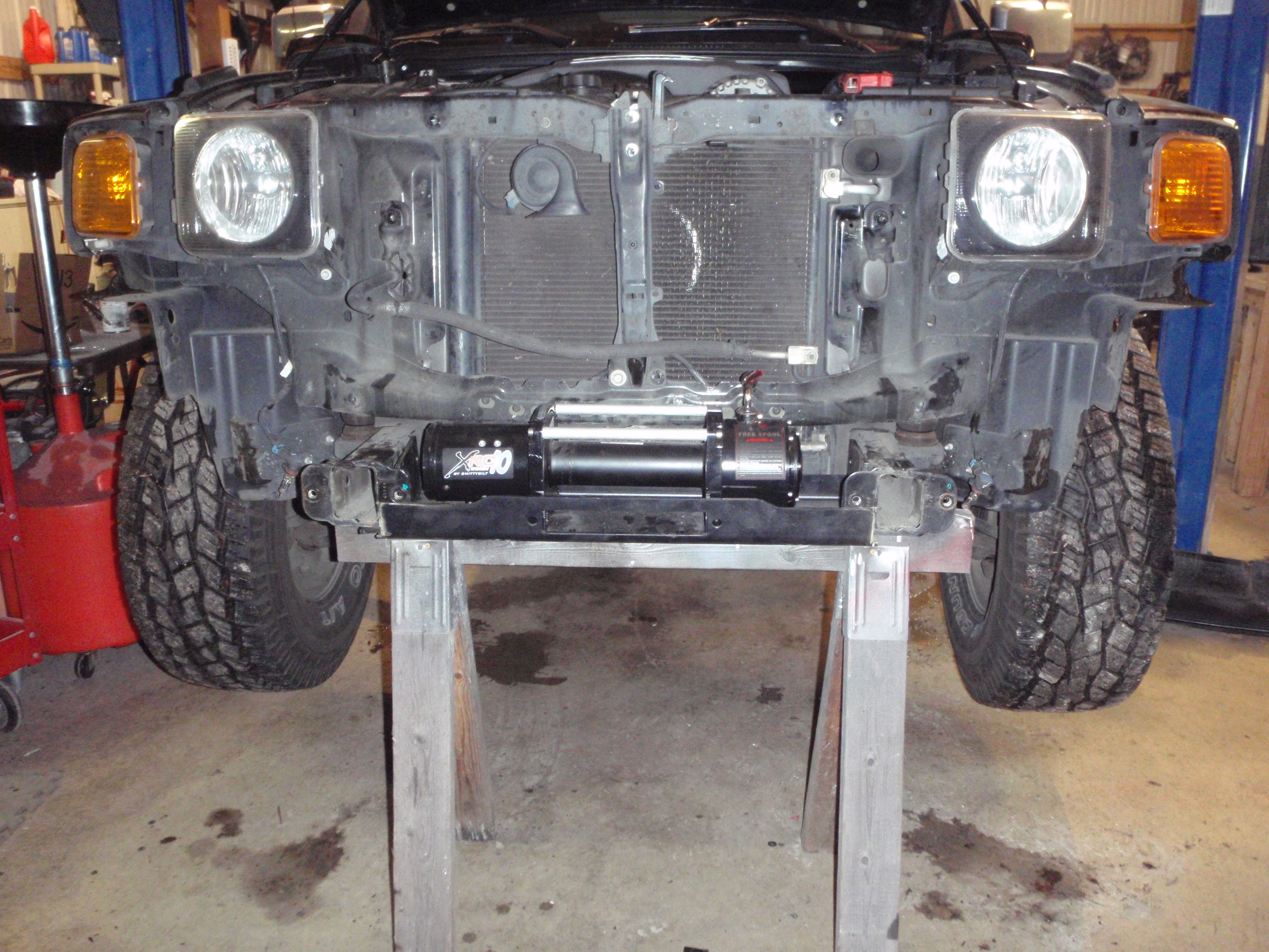

I'm a cheapskate, and I can fab.... here's my install of a winch on my H3
well, tonight's the night to wench... err winch
"stock" with a push bar I put on
Attachment 12688
scouting locations
Attachment 12689
hmm.... right behind that license plate looks good
Attachment 12690
remove air duct
Attachment 12691
of course you have to take the entire bumper off to remove the air duct
Attachment 12692
another JC Whitney "fits this application"
Attachment 12693
time to start planning some more
Attachment 12693
this looks promising
Attachment 12695
note, there's always a note that H3 Alphas need to use the more pedestrian other H3 brush guard.... now I know why
even with the cut, it's still too far forward
Attachment 12696
cut the lower part of the tabs that hold the tow hooks
Attachment 12697
benefit of doing it there is that's a great point of reference for the front
where I finished tonight
Attachment 12698
Tomorrow I'll weld the brackets to the plate, then drill holes in the frame to mount the wench.. er winch.... the snatch is in the back, two of them :grin:
SuperBuickGuy Jun 19, 2013 03:45 PM
part II
5 Attachment(s)
so it's finally where it needs to be
Attachment 12683
DAMMIT
Attachment 12684
a bit more progress
Attachment 12685
dang, if I hadn't told about the drilling the hole in the condensor, it'd look like I knew I was doing
Attachment 12686
eventually, I'll hinge the license plate... but for now, I just moved it up
Attachment 12687
