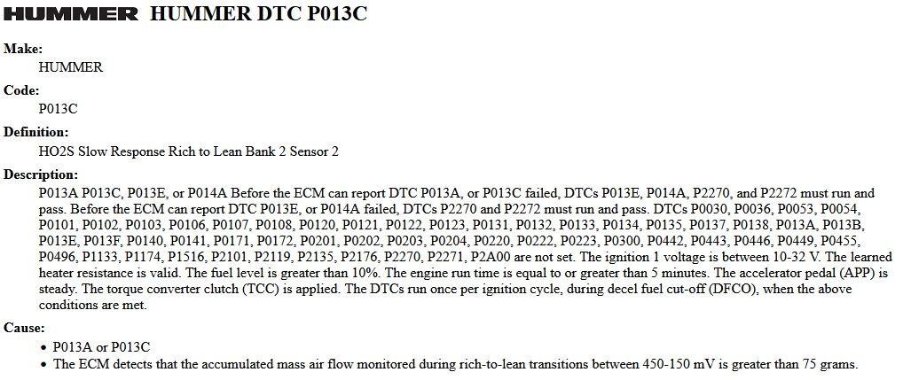

Found a BCM on ebay. Installed and hooray lots of things that were bad went away. Was programed and know my new key fobs off ebay was programed and I have 3. The BCM had got wet from the drain tube from sunroof. Tubes were cleaned out. TPMS works now. I know all this has been discussed here so on to the other problem. I have to pass emission test here in the Peoples Republic of IL. I have a code of P013C. Can anyone tell what that Is? And thanks to all who helped on all my H3 alpha problems.

Ok found it. Downstream 02 sensor.
Old Jan 8, 2023 | 07:02 PM
Posts: 9,014
Been busy with a $200k home reno. Clear code FIRST! Inspect downstream sensor for carbon buildup:
