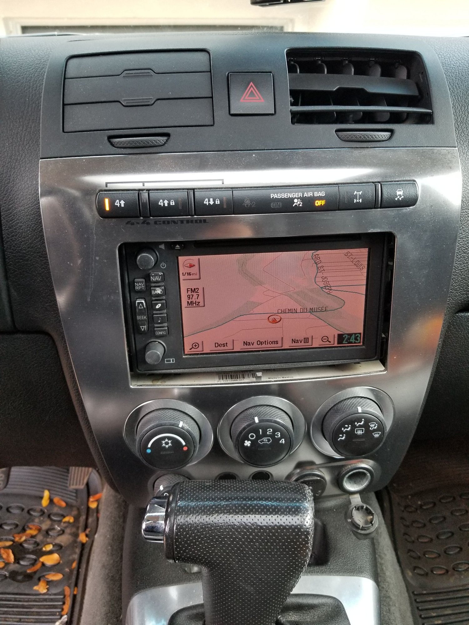

basically just get the bad *** adroid, that want to replace original ****ed up and burned radio.
the question- do i need some kind of chimmer?-, like some GM car of this time had ( i have a cobalt SS 2007, and i had cavalier 2004) if yes what kind?
maybe someone can trow me the link where i can buy the whole thing (mounting brackets, adaptors, antena adaptors, chimmer (if any) for 2 din. because the guy i know want to sell it to me for 250 can $ and think he is ****ing with me.

Any of the sellers of stereo equipment. https://www.crutchfield.com/S-q9rvadwGoHM/
They sell adapters and chime modules etc

Metra 95-3304 Dash Kit
Metra 40-GM10 Antenna Adapter
Metra LC-GMRC-01 Wiring Interface (this harness excludes on star but retains everything else)
Scosche gm1595b (just in case)
Basic stripped down wire harness no chimes, on star etc... Gm4004/70-2003 (just in case)
This information is correct for Base model stereos. Please confirm for Bose system before getting.
acually..... i dont know what i have... its a old touch screen radio with GPS..... where i can figure out what radio is it?
Old Oct 31, 2019 | 09:43 PM
Posts: 3,206
it would probably be stamped on the top or side of the radio when you remove it.
