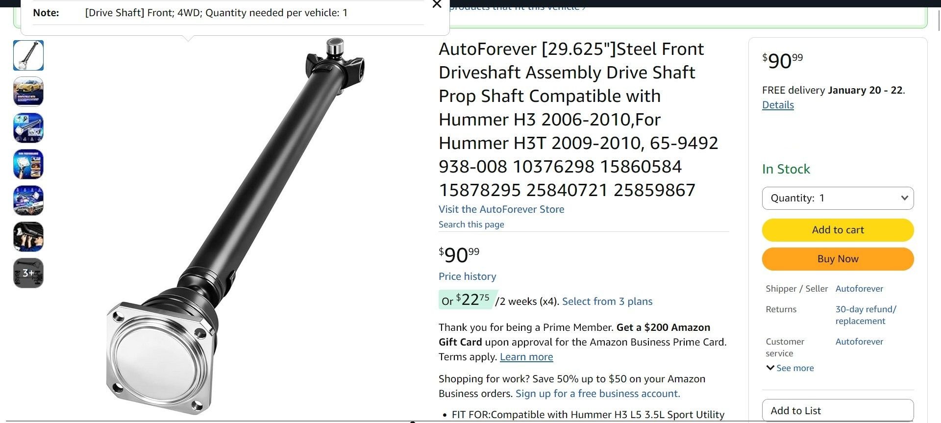

It sounds like a CV joint, specifically the front drive shaft CV joint. To check this first block your wheels and put the transfer case in neutral to take all stress off the shaft. Then just grab it and see if there is any play in it. The joint connects the front drive shaft to the transfer case, so check that end and not the front differential end.
You can change just the joint, and it isn't too bad if you have mechanical experience. If not you can always replace the entire shaft.

thanks! Just tried this…and while there is no up and down play, I am able to rotate it about a quarter turn. I think I might just replace this first and see if it helps.
I did replace the entire front drive shaft about 30k miles ago. It was making a much different clunking noise when it failed the first time. I went with a cheap $130 one from trakmotive that came with a lifetime warranty (it is now double that). The GM one at the time was over $1000.
so I guess we’ll see if they honor that lifetime warranty
