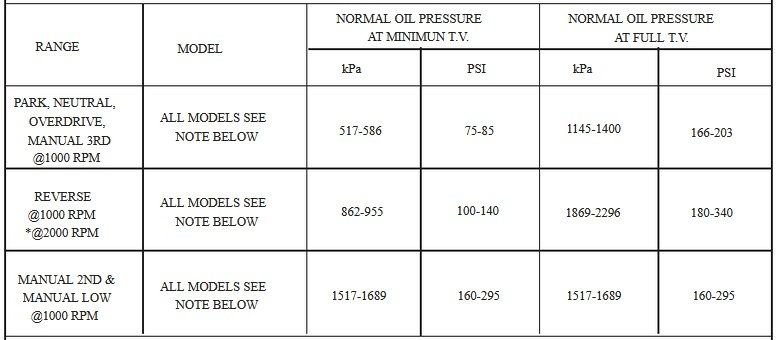

Did you check line pressure?

First, don't ever drive above 30mph in 4L! Second, driving in 4L increases TV position. Checking line pressure is 1 way to diagnose.

Ummmmm ok. At 30 in OD the RPMs were not anything of significance to worry about. And it’s not like I went to town like that. It was just down my driveway to verify it was cycling through all gears. Which it is. I’ll check the pressure tomorrow. Thanks.
