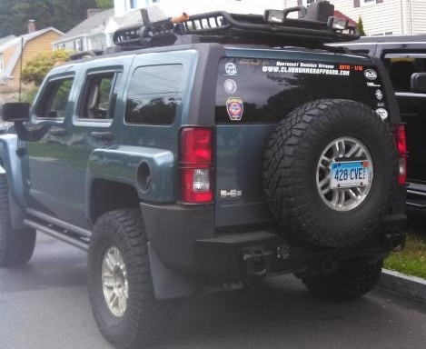

However, you need to be aware that your truck that came without an OEM hitch has a different rear bumper than those that had the towing package from the factory. So add on aftermarket (this was hinted at by happythree) hitches will hang lower than the OEM.
Take a look at my OEM bumper that came with a hitch, it has a cut out in the center so the receiver can stay up tighter to the truck and not mess with departure/approach angle.

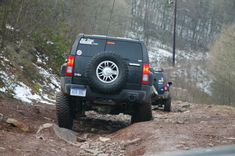

I don't worry about dragging the license plate anymore.
