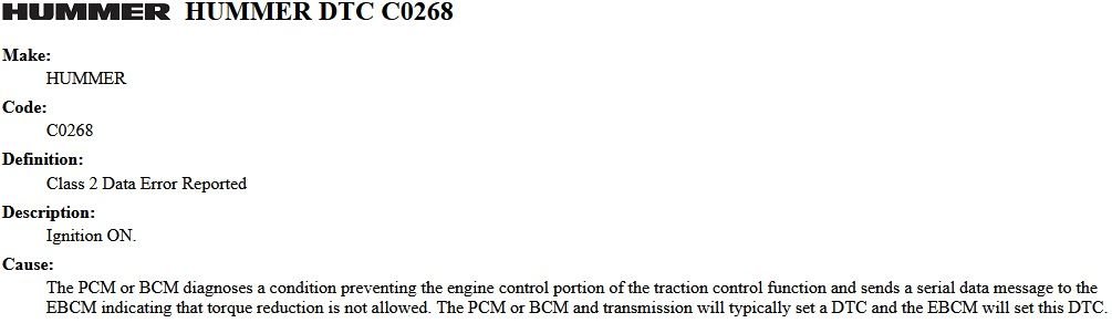

What I guess is that the tester used was not capable of pinpointing the original faults, so I need to get me one of the BCM testers.
Old Dec 2, 2022 | 11:29 AM
Originally Posted by Cymru
Can you tell me which one is recommended? Thanks
Sure, courtesy of hummerz...........
STOP wasting money! Get a quality scanner:SCAN TOOL
