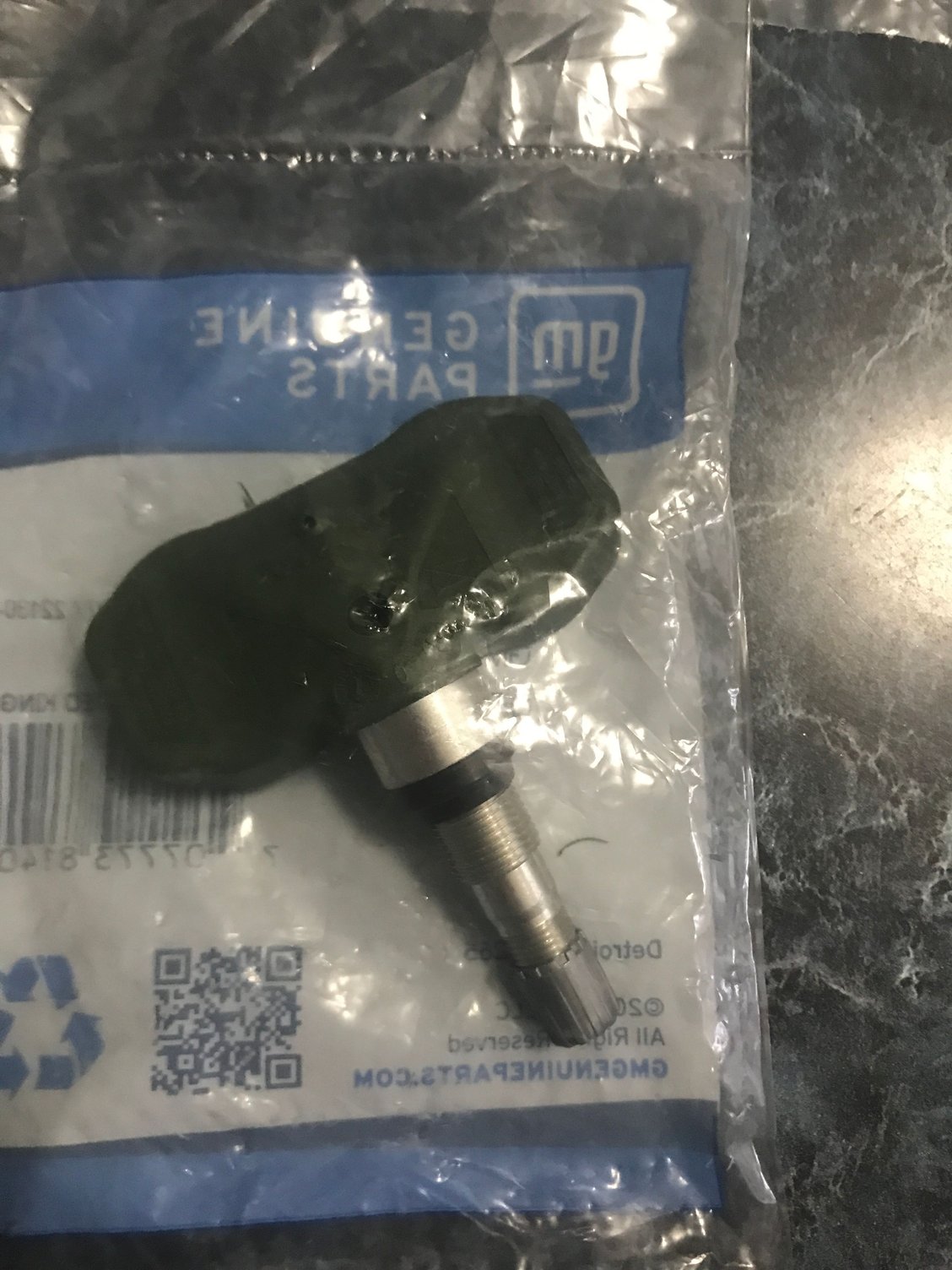

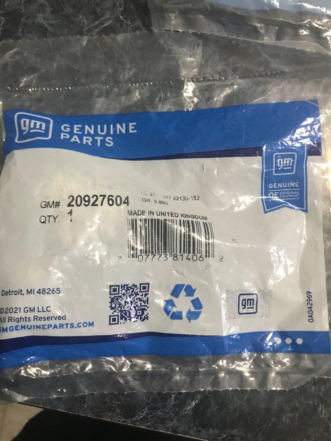

I bought 4 new GM sensors and they dont come with the valve stem nuts so had to buy those also, my question is does the oem metal valve stem nuts have a washer behind it?

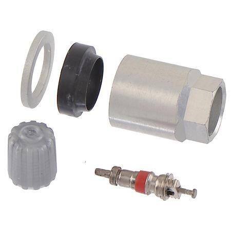

New sensors and you needed to buy new service kits?
Most NEW sensors come complete like this:::>>>SET OF 4 315Mhz TPMS SENSOR for CHEVY COLORADO GMC CANYON HUMMER H3 H3T OEM Spec
Install:

No good. The shops I worked at over many years with tire installation, had 2 kits(multiple part numbers) TPMS COMPLETE(same I posted above), or a service kit when new tires get installed:

The Genuine OEM GM TPMS don't come with the nut & washer. Have to purchase the "kit" separately.
hummerz maybe does not understand the difference between OEM spec (aftermarket part) and Genuine GM OEM parts

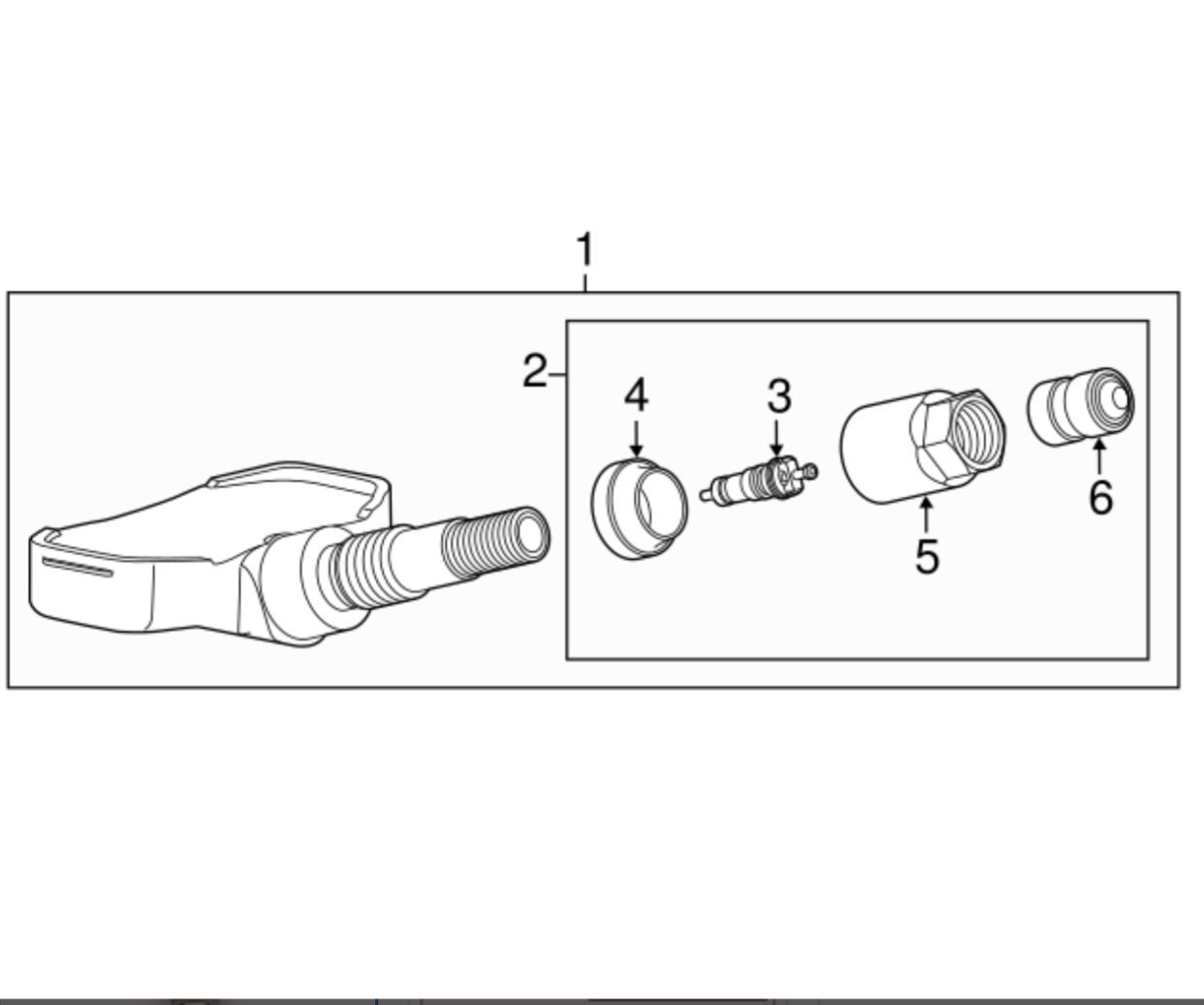

i ordered the nuts but out of every dealer, parts place and people ive asked 50% say no washer and the other half says washer. This is the image for my sensor on the gm website

GM doesn't manufacture TPMS.
Schrader is the largest OE TPMS supplier, equipping over 50% of new vehicles globally.

With steel wheels no washer needed, with aluminum wheels the washer is added protection if they corrode. Just install without the washer and check for leaks with soapy water.
