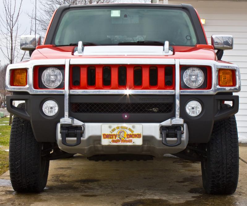

Ok, I read every post known to man and finally decided before putting 35's on my H3 Alpha, to see if it can actually be leveled.
1. After 6 turns on driver side
2. After 7 turns on pass side
3. I gained several inched and have about 8" of fender clearance on the front and back all sides.
4. Get an alignment...you can see in the photos that there is now a negative camber to my tires....tires are crap anyway but tomorrow it goes in for an alignment ($59 and worth every penny)
5. Ride is a bit more noticed but at least the vehicle is not raked.
6. All you need is a jack (I used a board to keep my skid plate from getting scratched)
7. 1 1/16 socket
8. Marking pen (mark the head of the bolt so you know haw many turns you turned.
9. Tape measure (You probably do not want to raise the front more than the rear)
10. Enjoy a much better look and get some beefier tires.
I am running stock 18" wheels with 295 75 18's. Comparable to 31's. (I am choosing NITTO Mud Grappler's) Best price and performance level.
I like the look much better when driving...I actually had to adjust my seat to accommodate the new view. Many say buy Torsion keys....in my opinion pure waste of $200 that I could use on Bilsteins for the front but that is your decision. Not sure of the new travel but who cares....you are in a Hummer.
Now they look funny so judge your own vehicle and not mine.

Pics look great. I have the same wheels, no tires on them yet. I'm thinking of 35's as well. I spoke with a guy about 305/70/18 Nitto's. He said a 9 in rim is preferred over the 18x7.5. What specific size are you looking at? Thanx
