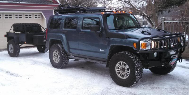

I have a 2007 H3 with a ThorParts bumper and a Predator S&R Brushguard along with a winch. That's a lot of weight. I just adjusted my torsion bars to bring up to level, added 1/2" extended bumpstops and better shocks. NO problems with nosedive, steering or handling. It's been 4 years, no issues.

What size tires are you running in that pic Bunger? I'm looking to upgrade my stock 265's to the 285's. Just curious how much taller they are.
I am running 315/75/16.
265/75/16 are 32" diameter
285/75/16 are 33" diameter
305/70/16 are 33" diameter but about an inch wider than 285
315/75/16 are 35" diameter
All above tire sizes will fit on an H3 without ANY modification.
