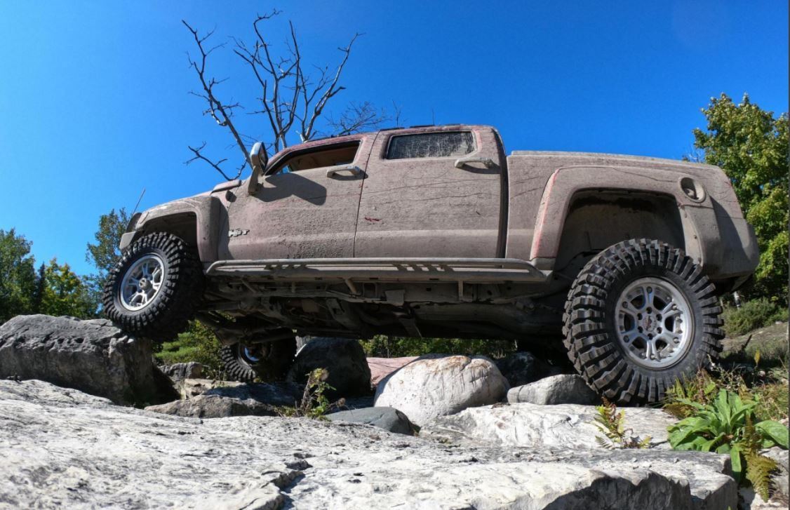

-OffRoad? I successfully wheeled our 2010 H3T Alpha OffRoad with a body lift on 37s for many years until harder and harder trails became my vice. Blew up several front IFS differentials. Skipped the IFS lift kit and went directly to option 3.
-Looks? If it is just for looks do a 1.5" body lift (Outfitter Design) and level the front to 23.5". You can run 37s and it looks good (IMO).

3. Skip the IFS lift kit and go SAS/SOA (Solid Axle Swap/Spring Over Axle). Once again expensive but you no longer have to deal with the weak IFS front differential.
1.25" body lift, leveled 23.25" and 37x12.50R16s
SAS/SOA
