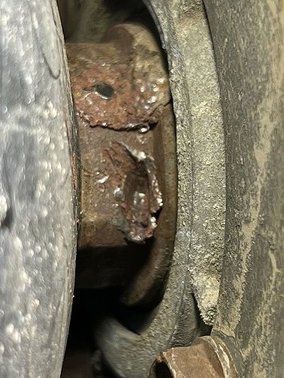

I'm looking for ideas on how to remove a stuck fan clutch on my 2009 H3 Alpha w 130k miles that spent most of its life in Ohio. Someone in the past used an air chisel on the nut and damaged it. Not sure if they actually got it off, or just gave up and left it on. Clutch is bad and has to go.
I have not been able to budge the nut even using a pneumatic fan clutch wrench with my air hammer. Maybe I just need a bigger air hammer or compressor? I'm using a small 90 psi 4 gallon compressor and short barrel air hammer. Wrong tool? I don't thing there is enough room in there to get heat on the nut without damaging the fan blades, but could be wrong on that. Anyone done that?

Have you sprayed it with Kroil or a good penetrating nut buster? I would do that 2-4 x per day for a couple days, then see if that helps. If that does not do anything, it is time for some heat. Worse case, remove the cowl and radiator where you can get after it... then just go full water pump replacement if that sucker is not giving up.
The FC Nut should come off using a fan clutch wrench and one tiny tap with a hammer. You have a a deformed mess that some knucklehead before you created. I bet they bent the nut out of round so it is stuck good like a crush lock nut.

Sawzall is my last, last resort if all else fails. There's only 1/2" of working space between fan clutch and pump pulley, so no way to get a cutting disk in there. I'm also not sure if the sawzall will will work on the heat-treated water pump shaft - that's a pretty thick chunk of steel to cut through in a tight space using a long blade.
Next on the agenda of things to try is heat and beat - I picked up an extension hose for my MAP torch today so I can get it in there tight and put heat right on the nut. I also picked up a long barrel air hammer so I can beat the pneumatic clutch wrench a little harder now. I already removed the plastic shroud so there should be fewer things to set on fire. lol.

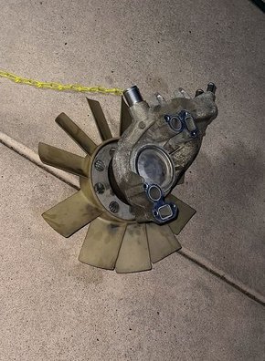

Yeah, agree there. Heating the clutch nut didn't get me anywhere, but I now have a fan with a nice brûlée on it. lol. The nut is stuck on there but good - What a PITA this job has been!
I started the job thinking I would just replace the fan clutch, easy peasy in and out. Then when things went south I bought all the parts to replace everything if I needed to. The truck is at 130k miles and I really don't know if any of them have been replaced before. Yesterday I pulled the pump, clutch and fan as a complete assembly, so no cutting on the vehicle needed. New parts are are going in this weekend. I'm still gonna see if I can figure out how to separate the fan from the clutch and save $100 on the new fan, but I've got one arriving tomorrow if I can't.
Silver lining, I now have a new, bigger air hammer and a fancy pneumatic fan clutch wrench. Last time I did a fan clutch was 15 years ago (maybe longer) and I still have the BMW specialty tools from that job, so I might just return the fan clutch wrench and recoup some of my $$$ there.

I looked and did not see that you know it is a left hand thread (reverse thread) so you need to loosen it by turning the wrench to your left.

Yep, that's what I was doing. For good measure I did try the other way too just to see if tightening it might let me loosen it. No matter what I tried the nut never budged. I wish I could get it off so I could figure out why it was stuck.
After I removed the whole pump/clutch/fan assembly from the truck I clamped it to a work bench and gave it my best shot. Air hammer with the pneumatic fan clutch wrench, pounded with a 5 lb sledge and punch, then chisel, then went to town on it with a sawzall. After dulling three blades trying to cut through the solid waterpump shaft I gave up and tried to split the nut alternating between air chisel and my sledge with a real chisel. No joy there either - there isn't really enough space to get edge to edge on the nut and it has a large flange against the clutch that needs to be split also. I think a longer chisel bit on the air hammer might have worked, but as soon as that new Dorman fan arrived I I moved on and put the truck back together.
One thing I noticed with the new clutch and water pump is that there is now a gap between the water pump pulley and the fan clutch nut that I didn't have with one I took out off. Either way, its back together and running fine now. No leaks!
