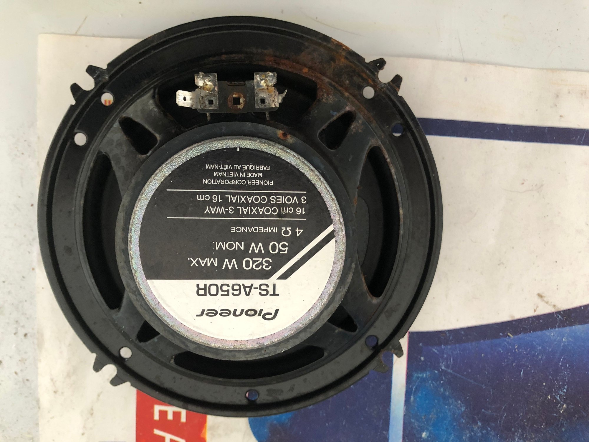

OK, I removed the rear side door panels for a look and sound test while looking. The clipping started at around 17 on the volume dial and from there progressed. I took a video that I will try and post and for one, I was very disappointed when I saw these cheap speakers! I usually don't run speakers unless they have big heavy magnets. Anyway, I removed the rear side doors because they wouldn't be a burden if I needed my vehicle right a way. There definitely was some rust, but, normal for 8 year old speakers non protected in a door. Everything else looked fine. I WOULD NOT use whoever installed this system again though. And, I will not put these speakers back in. Damn feather weight crap anyway....... The speakers say a minimum 50 watts up to 350 watts...... They don't look like they could handle 20 watts.... Maybe I will check youtube reviews on this model of speaker.... AFTER, I removed both rear speakers, I turned my stereo back on and omg, let the clipping begin! Does having two channels open, cause this??? I know you shouldn't run a stereo without speakers attached, but, I think that is IF you go at a high volume.... anyway, The front speakers clipped all the way as I turned the volume down to '0'........ I'm now thinking my problem is with the front speaker/s..... I'm pretty sure my stereo is just fine as I've been able to crank the tunes on a good day,,,,, I don't know if it got worse or not as I moved the door back and forth or coincidence... I am just going to keep my stereo off until I place a custom speaker box of (4) 6x9's in the back. I really don't need speakers in my doors and that will make wring easier. Anyway, I will think about it. Maybe replace the door speakers and do a custom box with two good 3 or 4 way 6 X 9.... Anyway, I will see if I can post a couple short videos I took with my phone as well as photos... Sorry, said videos too long. Thanks fellers.....

they look like they where decent speakers. if you push on the speaker cones and they feel "crunchy" then the voice coils might be going bad or forign debreis might be the issue. if you have a Ohm meter check to see if the voice coils are anywhere near 4 oms plus minus maybe 10 or 20 percent.
Old Aug 20, 2025 | 01:23 PM
Rust and corrosion are not a speaker's best friend. If the rears had zero moisture protection I think it is safe to say the Fronts don't either. Using speakers with too high a Watt rating is just as bad as using speakers with too low watt specs. Low they can fry, high the head unit or Amp can't drive them adequately and they sound like chit and overwork the system.

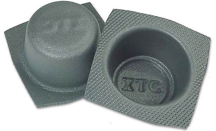

FWIW I used XTC Speaker Baffles on my old 07 and cut the bottom 1/3rd or so out so air could freely flow with the woofer. Kept water from above away from them permanently.
Used those since, and lately I have been using Stinger Roadkill FAST Rings. The foam may let some persistent moisture through, but air can move and not restrict the speaker.
