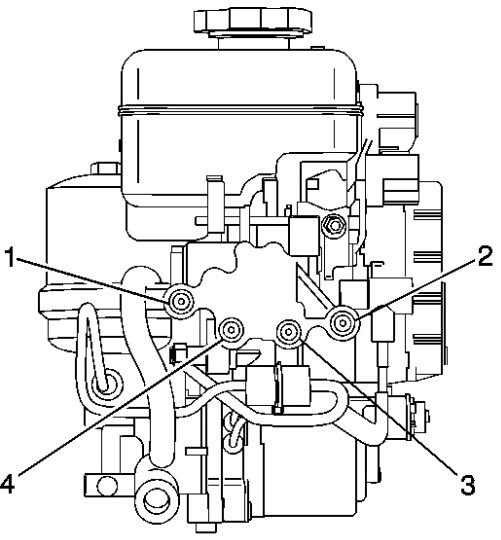

Posts: 9,024
AIR OR LEAK?
1. Place a clean shop cloth beneath the brake master cylinder to prevent brake fluid spills.
2. If you disconnected the brake pipes from the master cylinder, you must perform the
following steps:
1. Ensure that the brake master cylinder reservoir is full to the maximum-fill level. If
necessary add Delco Supreme 11®, GM P/N 12377967 (Canadian P/N 992667) or
equivalent DOT-3 brake fluid from a clean, sealed brake fluid container.
If removal of the reservoir cap and diaphragm is necessary, clean the outside of the
reservoir on and around the cap prior to removal.
2. With all brake pipes installed securely to the master cylinder, loosen and separate the
left front brake pipe (4) from the left front port of the brake master cylinder.
3. Allow a small amount of brake fluid to gravity bleed from the open port of the master
cylinder.
4. Reconnect the brake pipe to the master cylinder port and tighten securely.
5. Have an assistant slowly depress the brake pedal fully and maintain steady pressure on
the pedal.
6. Loosen the same brake pipe to purge air from the open port of the master cylinder.
7. Tighten the brake pipe, then have the assistant slowly release the brake pedal.
8. Wait 15 seconds, then repeat steps 2.5-2.7 until all air is purged from the same port of
9. With the left front brake pipe (4) installed securely to the master cylinder, after all air
has been purged from the left front port of the master cylinder, loosen and separate the
right front brake pipe (3) from the master cylinder, then repeat steps 2.5-2.8.
10. Turn the ignition key to the ON position.
11. With the right front brake pipe (3) installed securely to the master cylinder, after all
air has been purged from the right front port of the master cylinder, loosen and
separate the left rear brake pipe (1) from the master cylinder, then repeat steps 2.5-2.8.
12. With the left rear brake pipe (1) installed securely to the master cylinder, after all air
has been purged from the left rear port of the master cylinder, loosen and separate the
right rear brake pipe (2) from the master cylinder, then repeat steps 2.5-2.8.
13. After completing the final master cylinder port bleeding procedure, ensure that all of
the brake pipe-to-master cylinder fittings are properly tightened.
14. Turn the ignition key to the OFF position. Depress the brake pedal 20 times.
