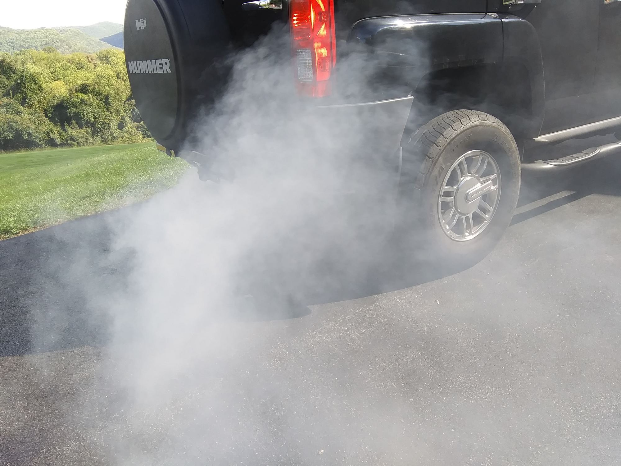

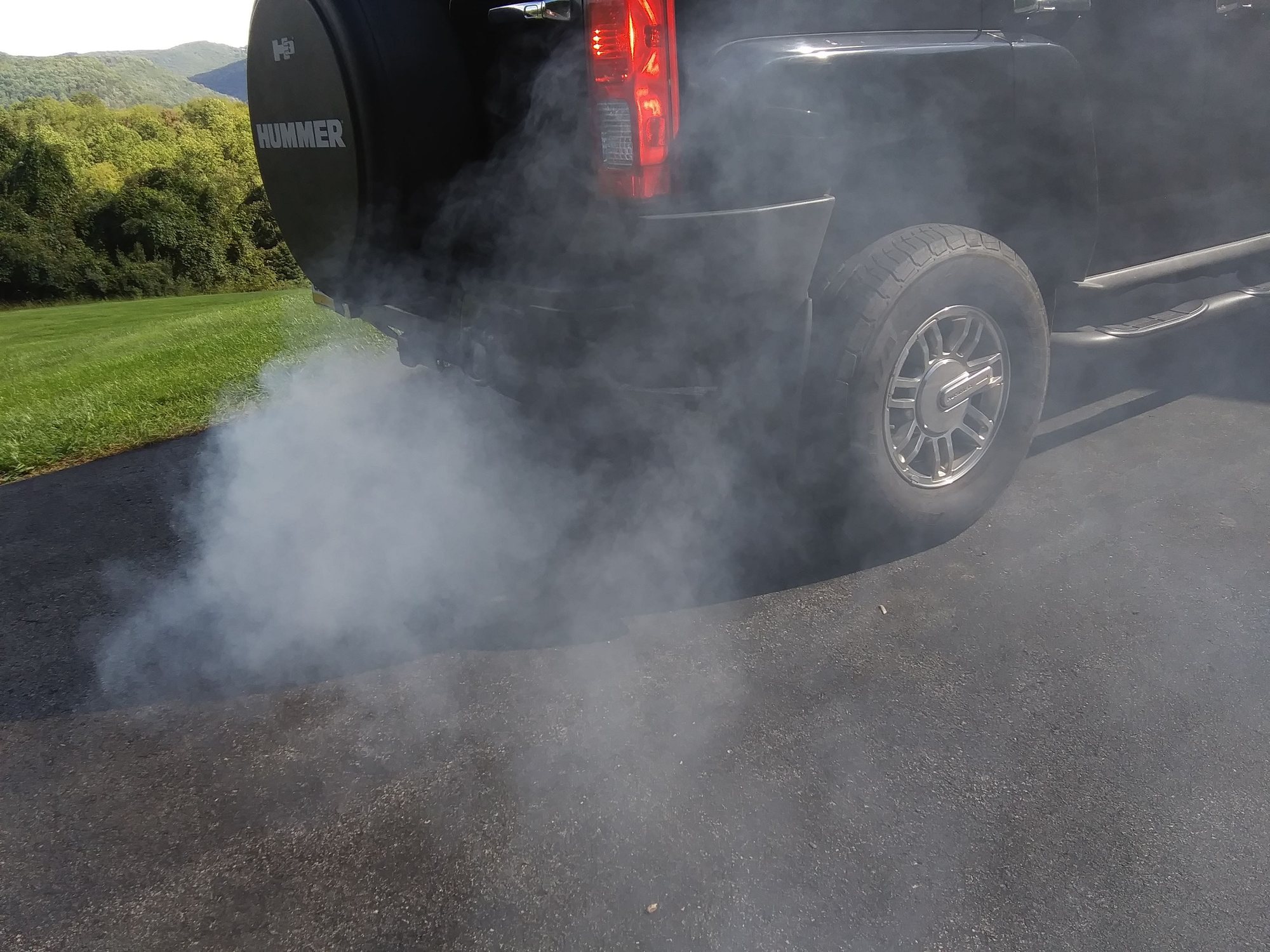

I picked up the car yesterday. The shop that has never been able to see it smoke finally did. We talked about possible causes and they said maybe the PCV hoses were plugged. Because I needed the vehicle I said would check those myself in the evening. The hoses are fine and properly connected.
I started the car this morning and got the same massive blue cloud that I get every morning. I called the shop and told them what I found with the hoses and that it was still smoking. I said it's time for them to remove the head and figure this out. They agreed. So tonight it goes back.
I'll update this post when there's an answer.
Smoke 1
And another.
Thanks guys.
