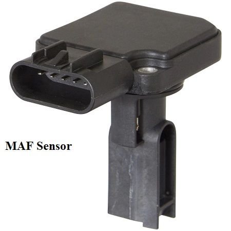

Yes, if MAF element was DIRTY it would skippity doo dah and not throw a code.

Cleaned Map Sensor, still have the skip at idle. Would a dirty throttle body also cause this to skip?

Follow the list on the thread I linked. Clean a MAF with MAF cleaner ONLY.
