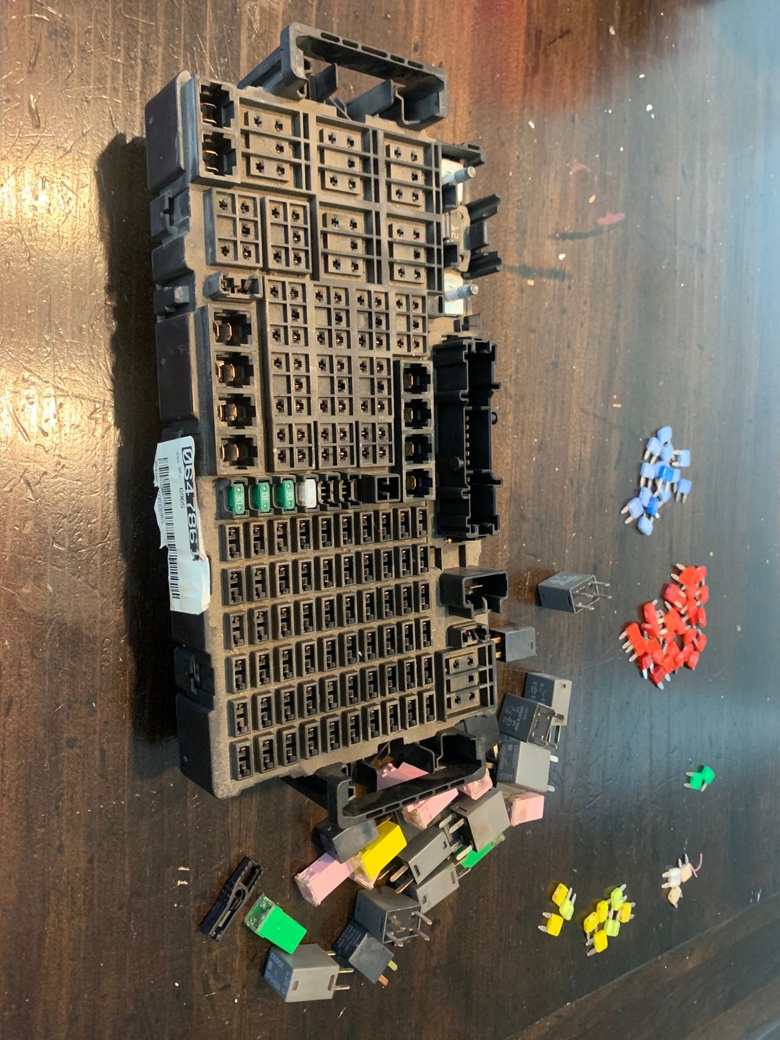

All of the fuses removed are showing short to ground on one side of the fuse terminal. The ignition fuse shows short to ground on both terminals. Once I disconnect the battery for a few days I can replace the ignition fuse without it popping and it will idle for hours. Once I put it in gear and drive it will move about 30-40 yards and pop the fuse and die. Even with the harness disconnected from the trans it still shows short to ground based on continuity on multimeter. I’m lost…..
Old May 19, 2022 | 10:26 AM
Posts: 3,206
maybe the short is in the fuse box? maybe corrosion inside of it?

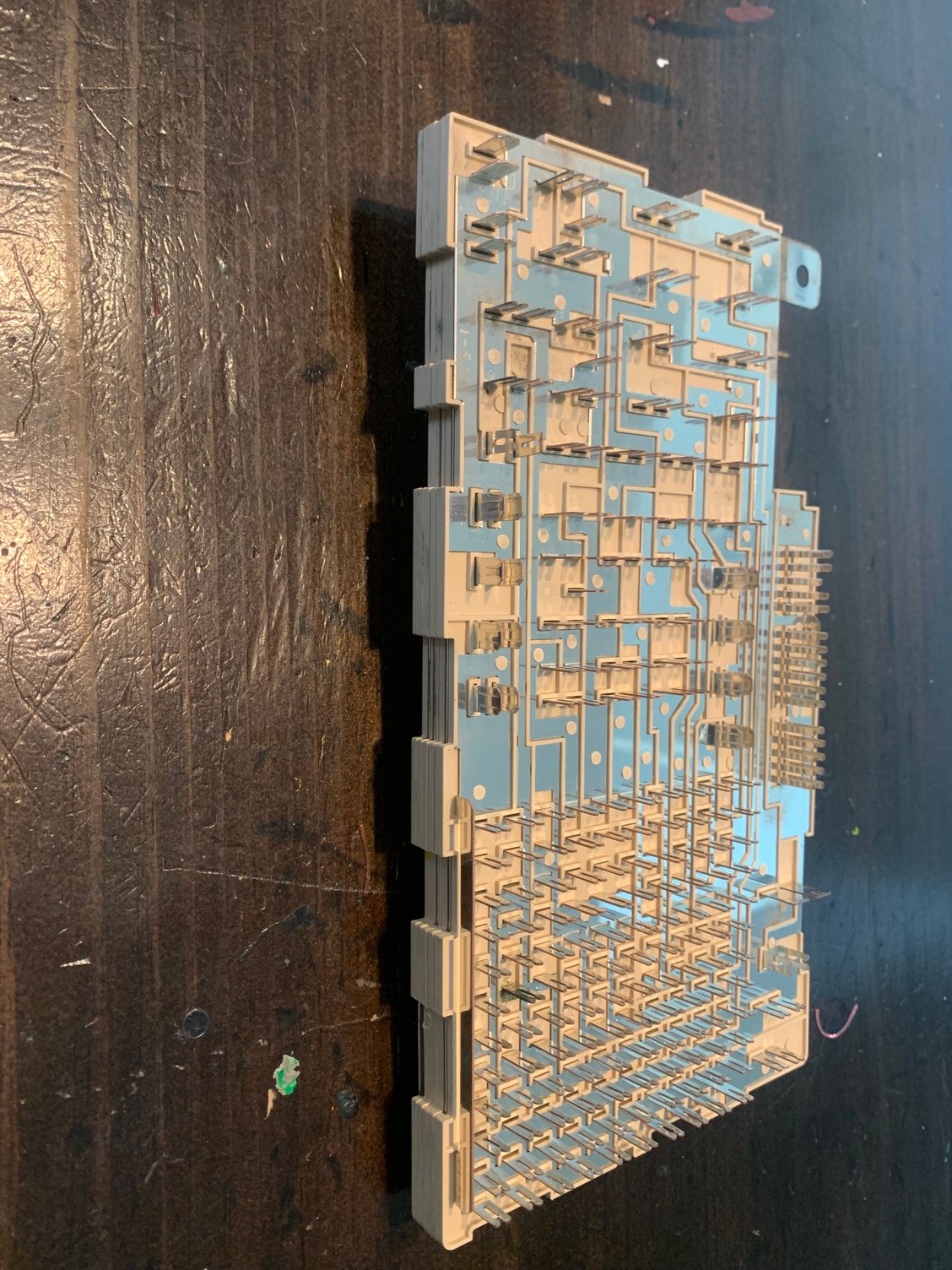

i pulled the fuse box apart and inspected the entire thing. No burn marks or corrosion.
