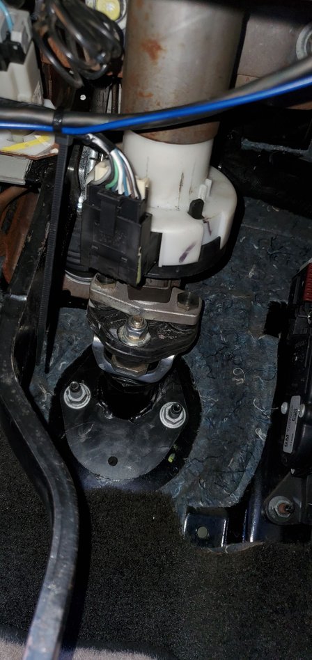

Make sure the swps connector(above the brake pedal) is properly secured. Clear all codes and recheck.
I checked and it is secured...it does allow me to move it though..... here's a pic

I already see an issue when comparing our pictures. The sensor on mine is not flush inside of that column sleeve....

I was able to slide it into place...I will clear codes and see if that does the trick... here's another pic
