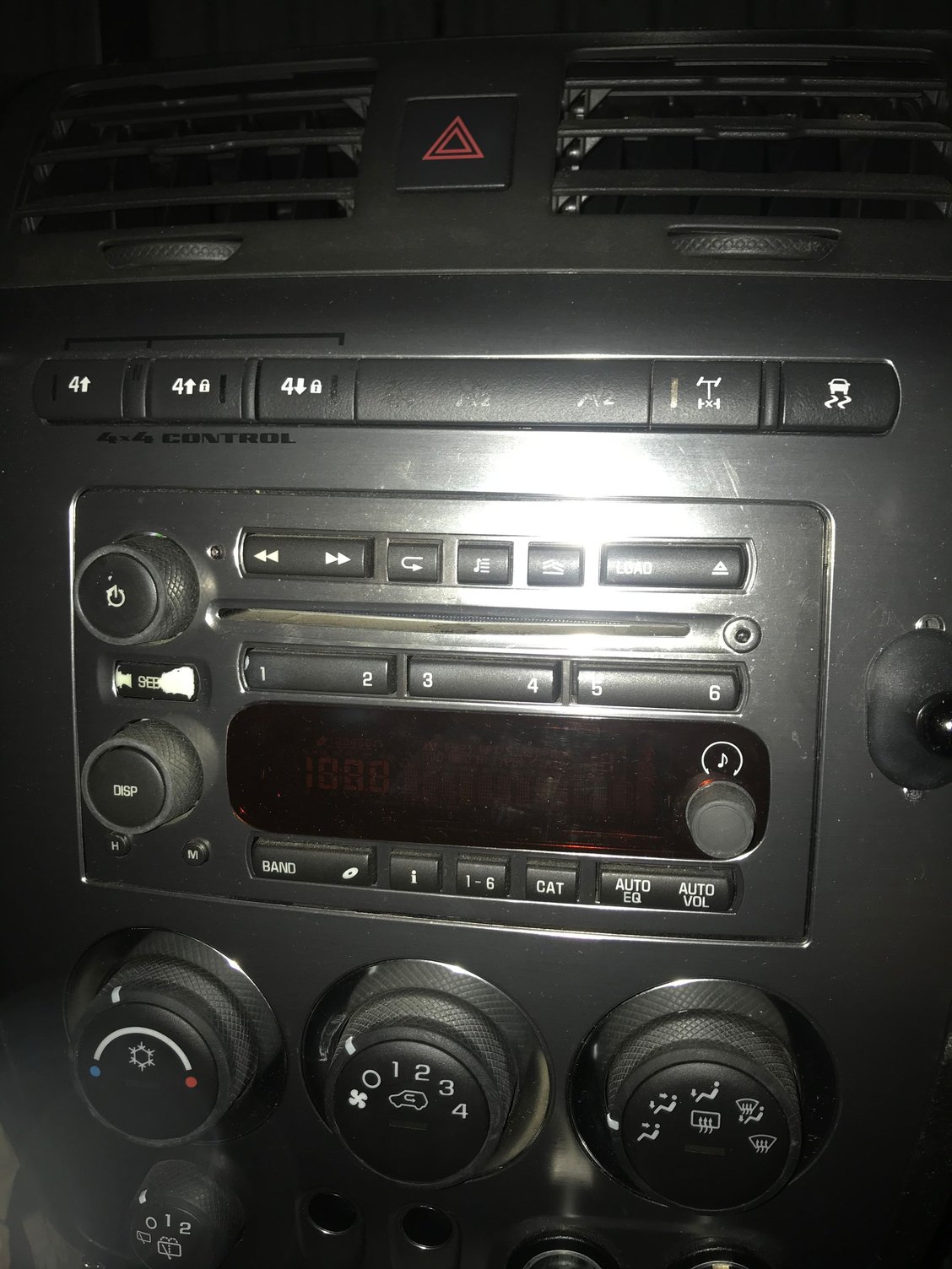

If it's a 2009 H3/H3T and has a locker it will ALWAYS have 2 lockers (Front & Rear) from the factory. 2006-2008 will ONLY have 1 locker (Rear).
Post a photo of your 4x4 control center and we can tell you what you have.
Also a photo of your door sticker showing the recommended tire pressure.

My rego/vin says 2009 but I did find a Sticker saying it was built 2008, now I’m confused lol not sure what model I thought it was adventure but it might be luxury.
also all the 4WD hi and lock and rear lock work!! Just don’t know about the error message every time I start the hummer
