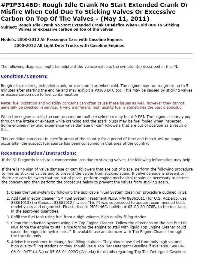

Sticky valves/excess carbon. Fuel system cleaner/induction cleaning/only top tier fuel.
