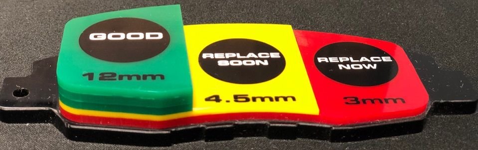

When was the last pad replacement? Time takes its toll on brake pads, especially in the salt belt, @ 20%, pad replacement was past due.

I would guess in the 4.5mm range. Was somewhat due but not down to wear indicators yet. Cracking pad is the issue. Not a common event 🤷🏻‍♂️
