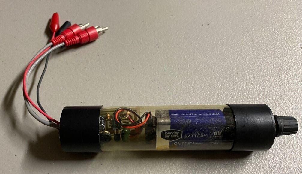

Is a tone generator a speaker? Like I said, test an actual speaker, if your speakers are toast, you wouldn't know that with a tone generator, would you?
Actually, YES. The tone generator produces a specific tone ( if you have a really nice one you can change the HZ of the tone from 50HZ to 15,000HZ in specific increments ) .
It passes through speaker level input (speaker wire or pre-amp level (RCA) if you have a really nice one.
You can even use it to check the phase of the speaker if you have a decent ear or can see the cone of the actual woofer.
If the speaker recreates the sound from tone generator the speaker is "good".
I use mine all the time. Especially when rewiring home audio for family and friends. I have found so many wiring issues done by the "Pros" with this simple little but expensive tool.

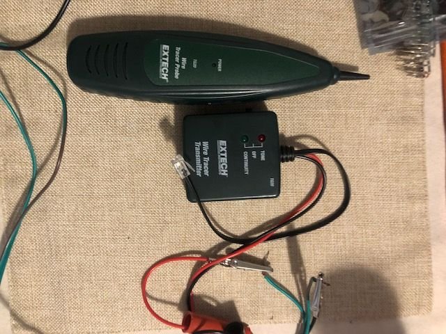

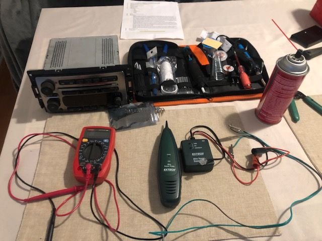

I was working on another project (redoing my shiner tank...subject for another forum) and took a break from that to read all your suggestions. I must say however that
Jeff Bezos is the biggest "crack" dealer on the planet. If I need a tool, Amazon has it. Here is what I have so far:
My next step is to check the outputs, grounds, and any other wires that could impede the signal getting to the amp.
