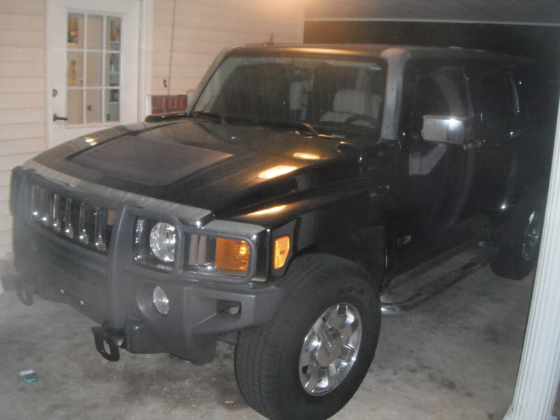

i have a 2007 H3 and i know it has the luxury package but how can i tell if i have the adventure package? whats the real diffrence?
also i went off roading with some friends a while back ago and my friend hit a tree with his F150 and bent his bumber causing his tire to be unable to turn. well hooked up a chain to the rear shackel on the h3 and his bumper. i put it in 4lo to get the tourqe and all my friends were telling me that my back tires were spinning and my front tires were not.
shoulent the h3 when in 4x4 locked shouldent the axels be locked and not have just one spin?
is there a special step to set your locked 4wd?

theres 1027 posts about lockers,adventure,switches by the radio.
no you do not have adventure. your friends don't know hummers, and,
you hooked a chain??!!
most likely some wheels were spinning front and rear. spinning gets you nowhere.

Might be time to real that manual in the glove box. All H3s have StabiliTrack and Traction Control. When you know what it is, and how it works, they are capable off road vehicles, except for the street tires.
The Adventure Package a base model with the off road package, Lux Off Road had the leather interior + the off road package. In 07 they came with 285 33" tires, shocks with larger piston diameter and valved to be stiffer, a low range T Case 4.03:1 (instead of the 2.64:1 T Case) and locking rear diff.
If you just mashed the gas, then your friends' description might not be far off because that is NOT how the system works. With a non locker H3 you have to let the TC work, bring up the RPMs to say 1100-1300 and hold it there while the TC distributes power to the wheels, slowly applying more throttle if needed. Too much skinny pedal is the first mistake off road newbs make.

What the above guys are trying to tell you is that:
1) NEVER use a chain, use only a strap and not a strap with hooks on it either, use a plain strap with the ends looped. Chains are dangerous.
2) You do NOT have a rear locking button to the right of the Passenger Air Bag indicator in the 4x4 control bar. So no rear locker means you DO NOT have an Adventure model.
3) like Doc says, slow and easy on the gas will distribute power to ALL wheels. Mashing the gas pedal will spin the tires with the least traction, getting you nowhere.
