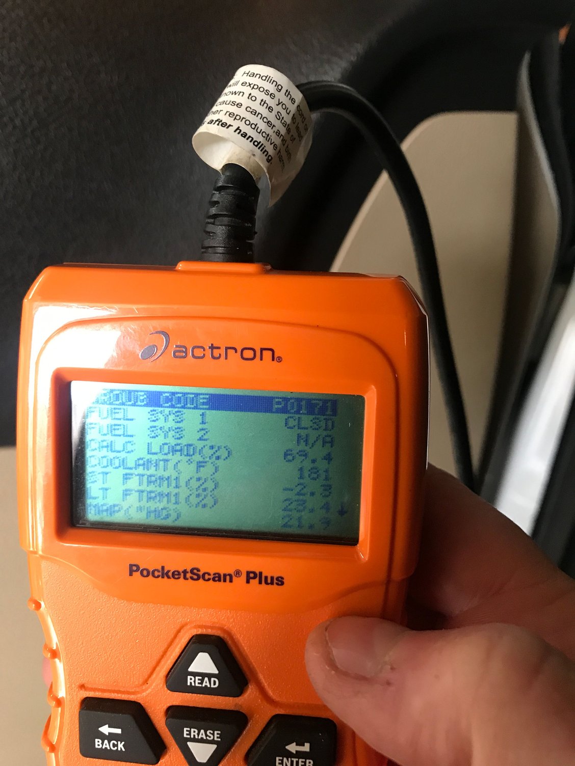

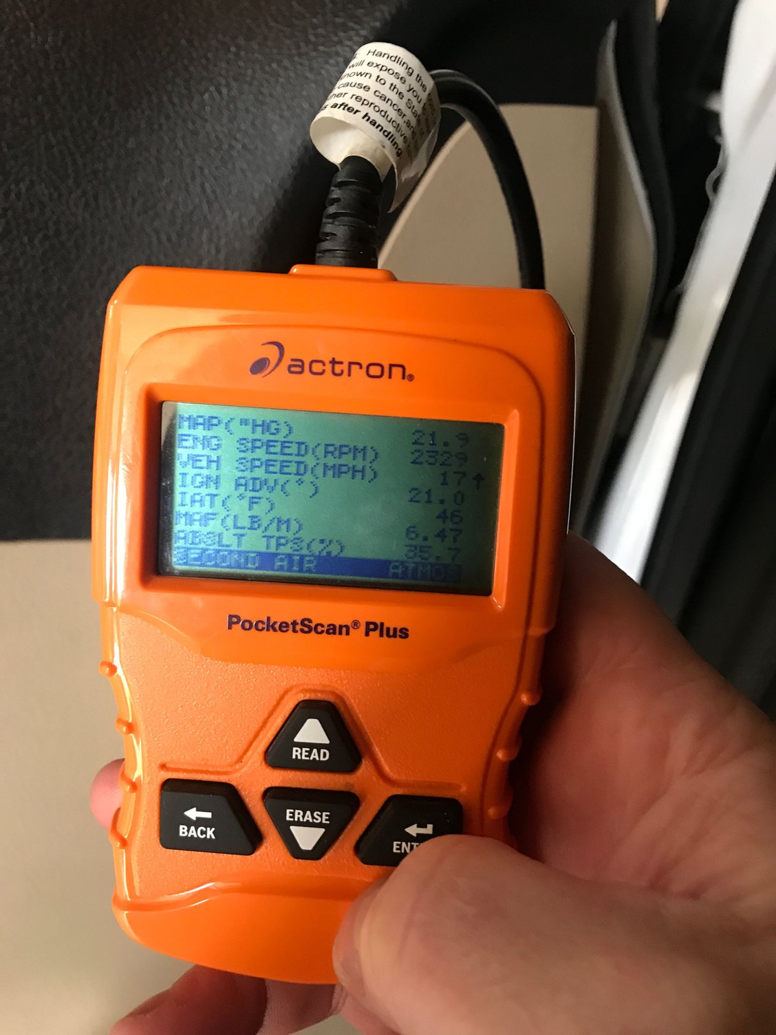

tonyb5150's Avatar
Joined: Jun 2008
Posts: 40
Here is freeze frame when code set today. Air filter looks new. I will recheck it’s alignment.
