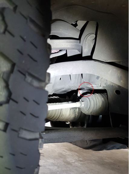

Hey guys,
After a day in the desert doing some light off-roading, I noticed that this rubber bushing (circled) or whatever it is, looks like its falling apart. After checking online, I can't seem to figure out what part this is or what's involved in replacing it. Any help would be appreciated. thanks! Note this is near the front suspension (passenger side).
Old Apr 1, 2019 | 01:00 PM

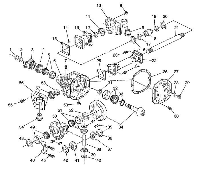

Looks like the front differential mount to me. But you photo is so blurry I can't be 100%
Old Apr 1, 2019 | 01:37 PM
Posts: 9,014
That is correct. #54 & #56 :

Thanks guys! So based on the diagram, it looks like that part (#54) is held by a single screw and should be fairly easy to replace, right? (or am I missing something)
Old Apr 1, 2019 | 02:16 PM
Posts: 9,014
#56 requires 4 bolts same part#. #54 has 1 bolt. You can buy the bracket with bushing or just the bushing.

Thanks! I can only seem to find the part # for the whole bracket. Would you happen to have the part # for just the bushing?

Old Apr 2, 2019 | 01:40 PM
They are sold together.
You will have to remove the CV shaft, which will require a lot of other parts to be removed. You will also need to support the differential while you remove the bracket.
Do a search for half shaft removal.
