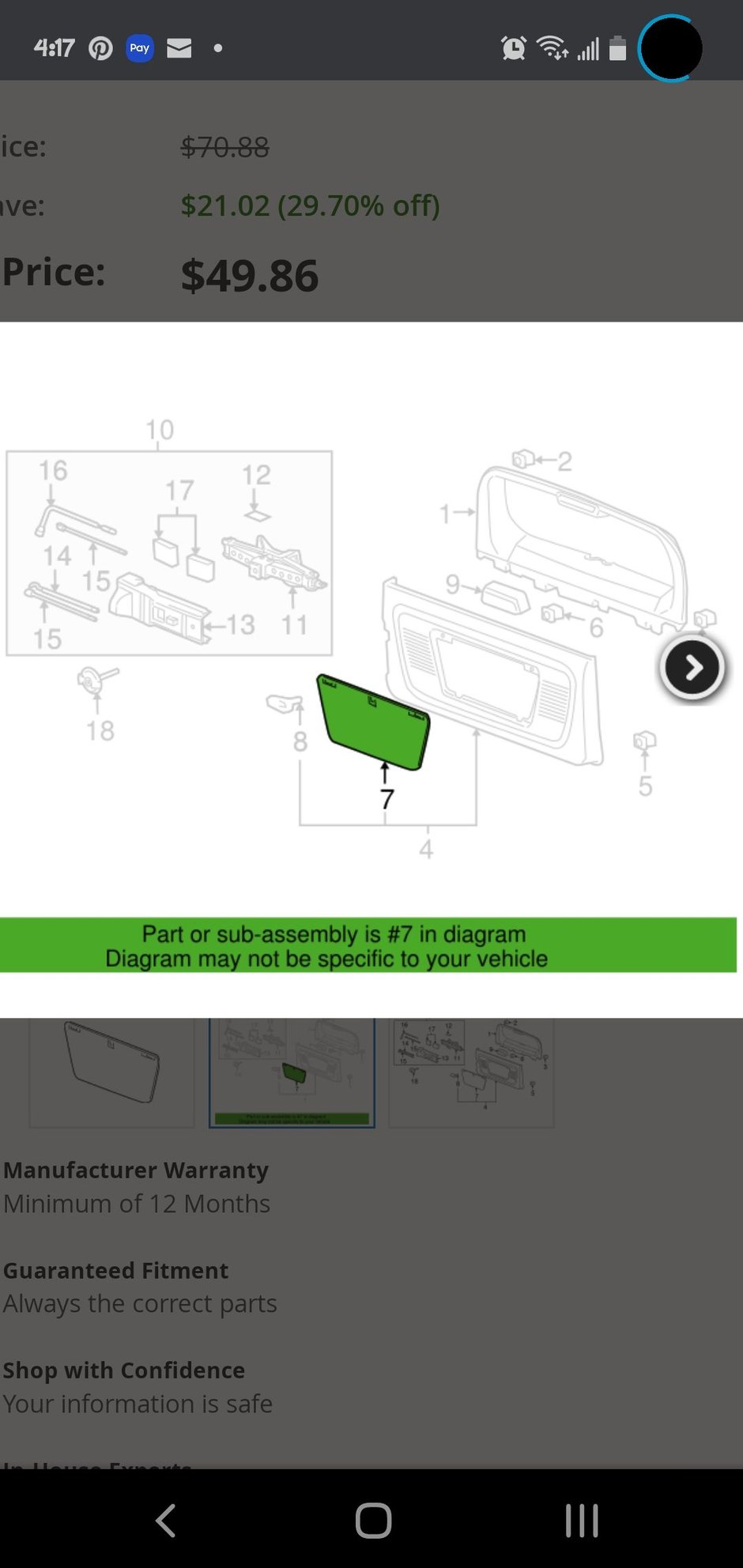

hey everyone,
I have a 07 h3 and the trunk jack cover won't stay on and I know why. I need new holding clips but I have no idea where to look for it. I been searching. On the diagram its part number 8. Its what keeps it closed.

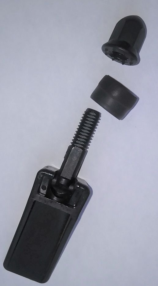

Did you break the latches? If not try tightening the nuts.
Picture of latch removed:

That's f'n crazy. It's a 2cent piece of plastic, lever, bolt, nut, and a rubber grommet. If all is still there, tighten the grommet, may need to add a small diameter washer to compress the grommet more.
I'm missing the rubber piece.

I'm going to rry the new washer
Old Jul 16, 2020 | 06:18 PM
The grommet is flexible, as long as you find something that fits through the mount hole and compresses/expands when latch is pressed, to hold door in place, you are good to go.
Play around with different diameter pieces of rubber tubing. All the nut does is hold it in place and when you flip the cam lever it compresses the rubber for an interference fit in the hole. Not an exact science.

Just measured. 1/2" O.D. x 1/4" I.D. x 3/8" Long will give you exactly what you need.
