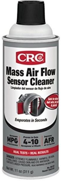

Don't jump to conclusions with the o2's, you can check fuel trims to see they are operating properly. Get back to the basics, start with a new oem type air filter, then clean the maf sensor again with a quality maf cleaner, and make sure the cai is properly secured after completion.

I went ahead and purchased an disposable air filter from autozone (STP) and the MAF sensor cleaner I already had, exact same one you have pictured. The code went away and didn't come back, drive about 60 miles. Doing a 3 hour drive home today so well see what happens. Thanks so much for all the help
