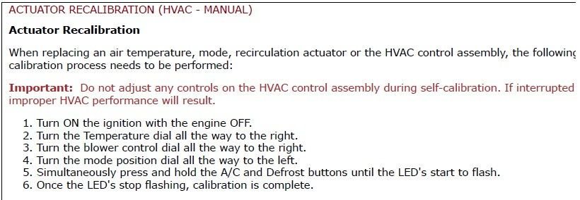

Calibration is required after disconnect!

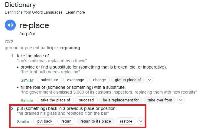

Just re-read HUMMERZ post and the re-calibration instructions say: "When Replacing An Air Temperature Control Assembly" NOT 'Disconnecting' as he posted. 'Replacing' seems to be the key word.

2 things to consider, and understand the meaning of "REPLACING":
1-OP has an issue after disconnect, was the key in the ignition & in the on position? WHY NOT TRY TO RE-CALIBRATE first?
2-OP asked if installing another HVAC control assembly, would it require calibration?
3-Removing the HVAC control assembly to replace bulbs requires disconnect! Replacing definition is noted below:

I'm thinking if you just R&R your original controller no re-calibration is necessary, as it retains calibration. Only if a NEW controller is installed THEN you need to re-calibrate.

Battery voltage disconnect can cause an issue with many different modules throughout all vehicle manufacturers. Requiring re-calibration, reprogram, or reset. I've never disconnected my HVAC controller, yet anytime my drivers door master switch is disconnected/losing B+, it became inoperative until reset(capacitive discharge). The factory radio requires reprogram after disconnect from B+. The HVAC may maintain residual voltage when disconnected, yet when not operating properly after reconnect, try to re-calibrate first.
