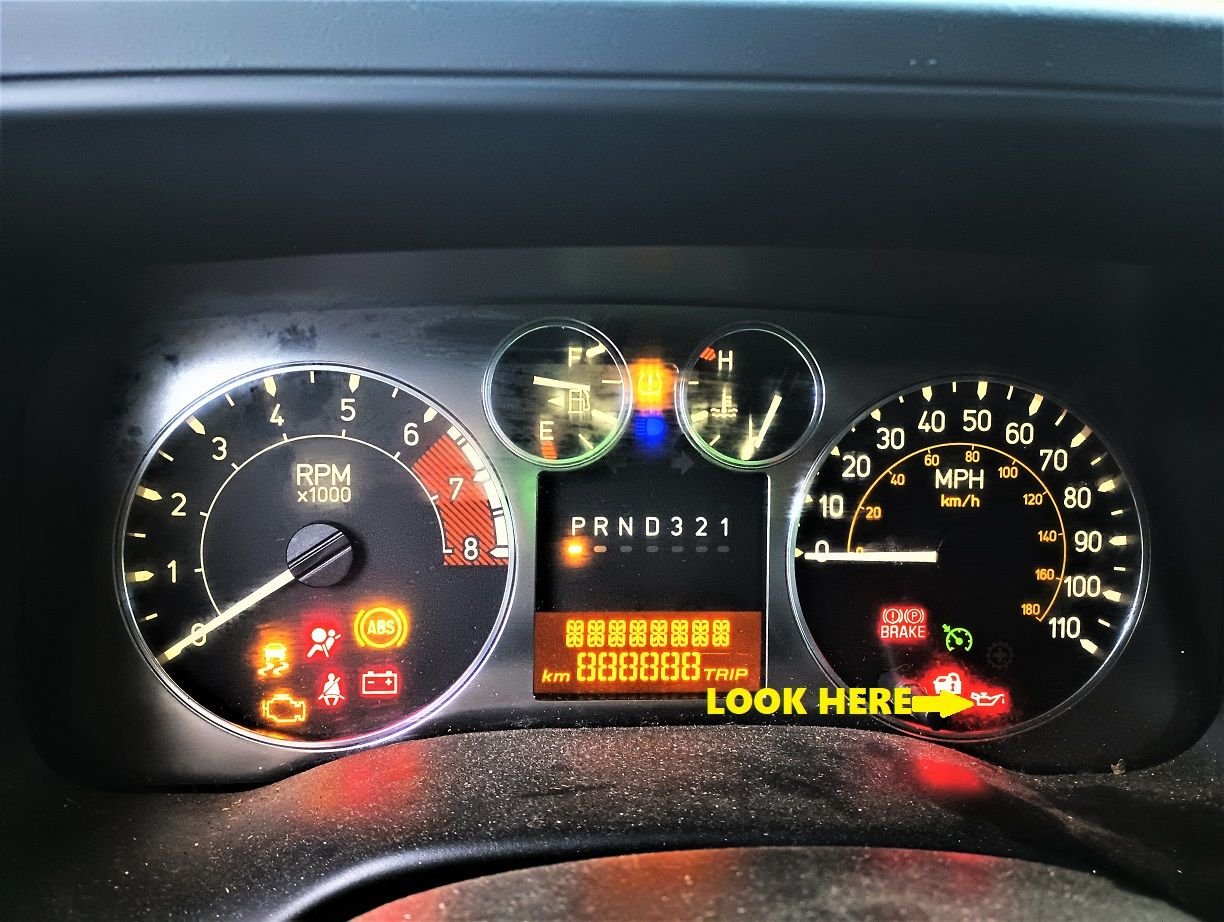

Hi Doc, I hooked it back up, no warning light ...
But the issue is that when it was disconnected there was no warning light, that's not right is it?

Did you try KOEO: IC bulb check?
Old Mar 20, 2023 | 06:35 AM
smtichy's Avatar
Joined: Oct 2021
Posts: 20
From: Prague, Czech Republic
Yes that oil symbol lights up when starting, then goes out. No further messages or warning lights when the H3 is running. The behavior was the same when the sensor was disconnected.
"that oil symbol lights up when starting" with the switch disconnected?

yes, when disconnected it works as if it were connected! It''s crazy right? I'm thinking something was reprogrammed in the PCM.
