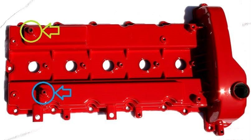

Old Jul 25, 2023 | 03:58 PM
Originally Posted by NFS
I don’t think the hummer have pcv valve
No old school style valve per say. The I5s do have a PCV metered vent in the "valve cover". Clean both of these.
Old Jul 25, 2023 | 05:09 PM
NFS's Avatar
NFS
Joined: May 2016
Posts: 739
oh yes I’ll try this weekend thank you

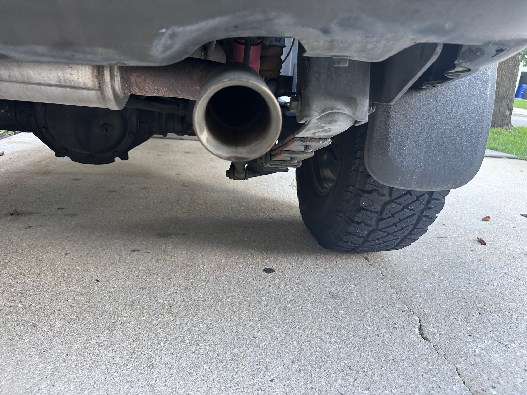

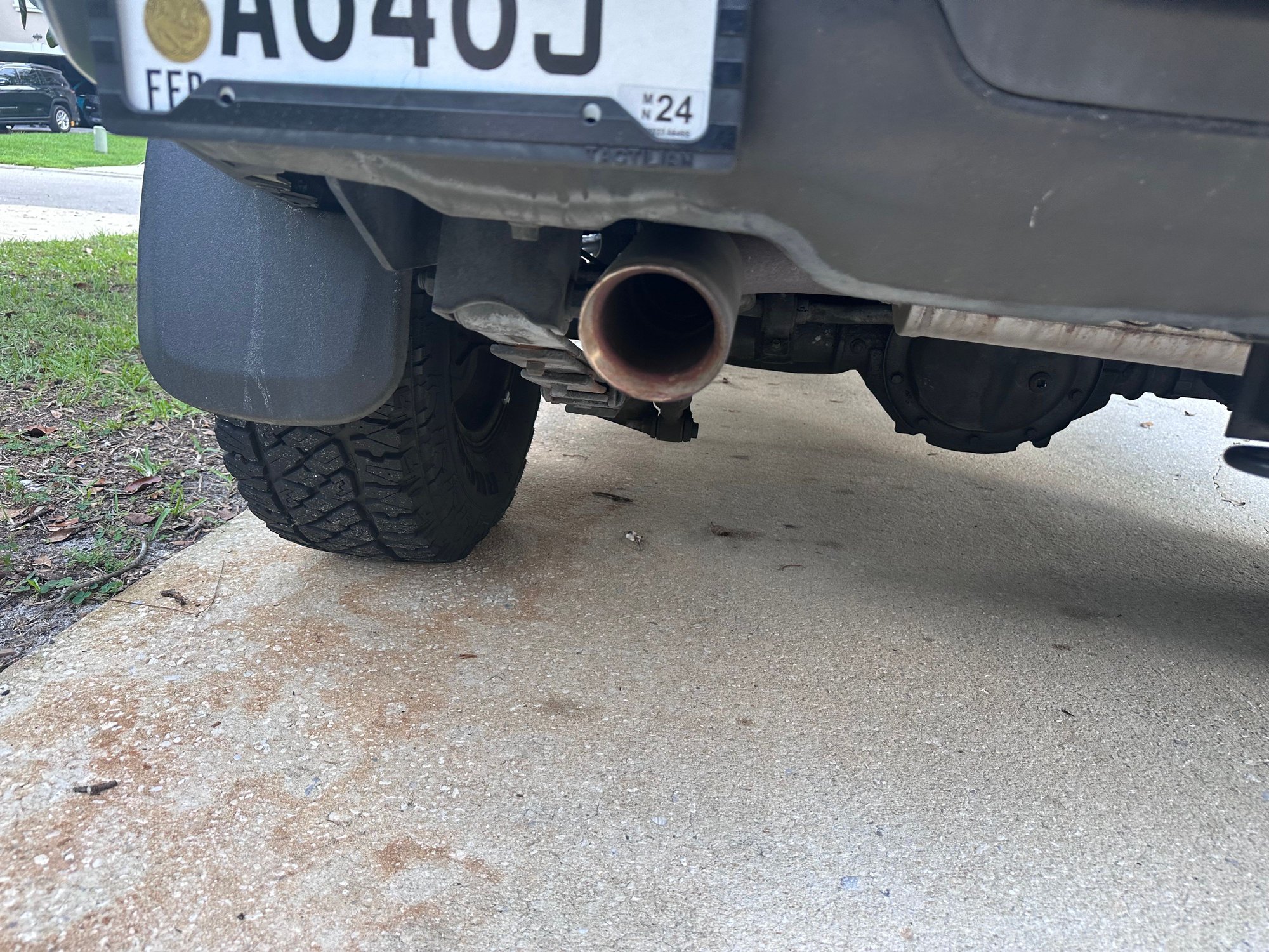

Joined: May 2016
Posts: 739
Originally Posted by Disel
what is the outlet pipe? The muffler must be clean and slightly corroded. but not black from soot. if it is in soot, then the engine consumes oil. and the fact that there is no smoke and smell, it is the catalyst that works. if the exhaust is clean, then check the valve cover gasket, especially at the rear. oil drips and blows away on the go. so no smudges but there is consumption. no more options.
I have Megna dual exhaust one of them is kinda dirty which is the left and one is normal, does that mean I have oil burning ?
Old Jul 30, 2023 | 07:51 AM
Justinh's Avatar
Joined: Feb 2014
Posts: 477
From: north Alabama
Neither one looks dirty or has any sign of burning oil - they look almost too clean to me
