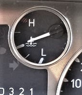

Driving on city streets, stop-n-go traffic on HOT days 90°F+, I see this on my gauge:

I’m with Hummerz, I live in NM at 90-100F outside, 5000-7000 ft above sea level, gauge is always one needle width below 1\2.
I did add water wetter to my radiator fluid when I bought it though.
