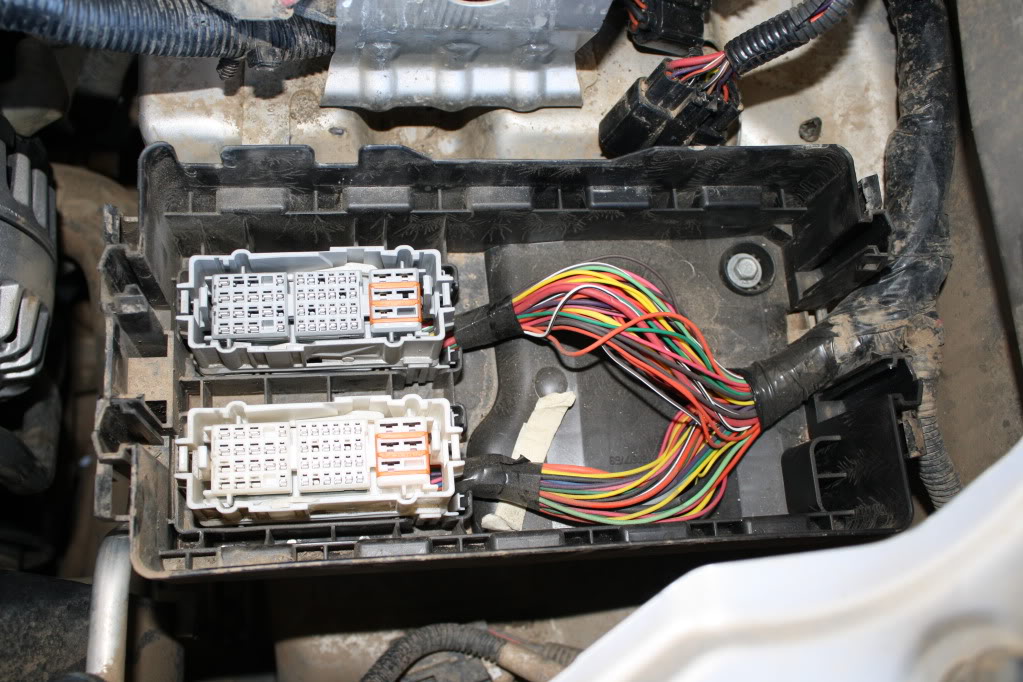

I have a 2006 hummer h3. I replaced the alternater and put new battery in. The key moves, will not come out, shifter will not move and no power. The fuses are good and battery showing 13.3 volts. Help please.

Did you take out the fuse block?
If so, check two things: 1) that the 12V + and - connections to the upper left of the fuse block were made (where the nuts go over the lug bolts; and, 2) that the wiring harness connectors under the block are snapped completely into the bottom of the fuse block.
If you just tried to push the fuse block down on top of the wiring harness connectors, you have about a 20-30% chance that gone done right. There is a trick to that, you have to pull out/up the harness connectors and snap them into the bottom of the fuse block BEFORE you push the fuse block and connectors down into the box. If that connection is not right, you will get no power to the truck.

Thank you so much. You must be a hummer God. It worked.

Back when they were selling the roof top off road light and the marker light kits, they connect to certain pins in the harness under the fuse block, this problem used to happen all the time. Once you learn the trick to it, no biggy. Glad to help.
