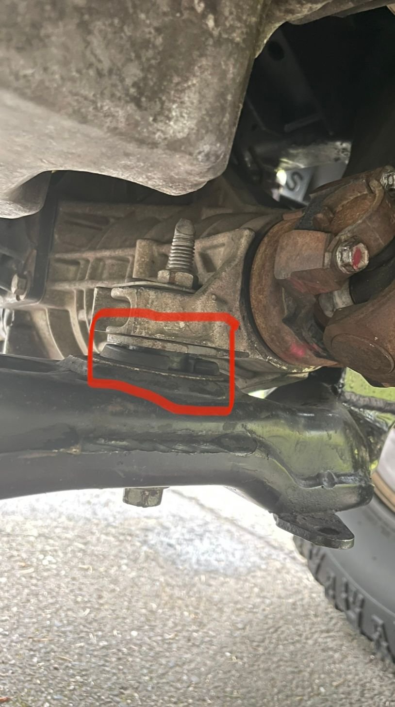

  • also noticed this rubber mount was cracked open.
    Cracked open rubber mount. I want to know what it’s called. Figuring it’s just unbolt add new? Is their a unique process for this fix?
  • there was a couple more that were not cracked through but didn’t seem tight, like a gap could be seen between the rubber and flange type washer.
    Aren’t They suppose to be flush and tight together with some torque spec?

Plenty of online info on the Differential Bushing(s), options and how to.

Originally Posted by Neromaniac
  • Aren’t They suppose to be flush and tight together with some torque spec?
Yes the crossmember and the front differential should be touching. Hold that top nut and hit the lower bolt with about 3 Ugga Duggas.

I really want to fix this diff. bushing and probably others.

Never heard of a grill causing any H3 rattle. Exhaust heat shield, bad intermediate steering shaft, loose front splash shields and your loose diff bushing can all make noise.
