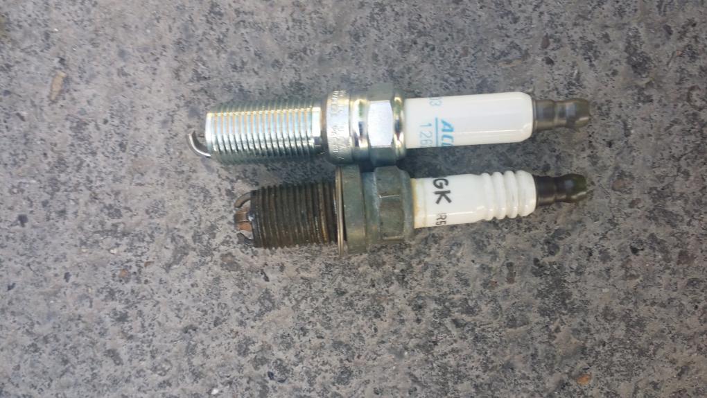

The one thing that I did not do was clean out the MAF for some reason it slipped my mind. when i changed out the spark plugs on my H3 I noticed that the spark plugs that were in my H3 were completly different than the acdelco ones i put in there. I put originals (new) back in there.. I attached a photo of the old spark plugs.

Save yourself some time and avoid driveability issues, ONLY use ACDelco 41-103 (12625058) iridium spark plugs (Alpha use ACDelco 41-110 (12621258)).
